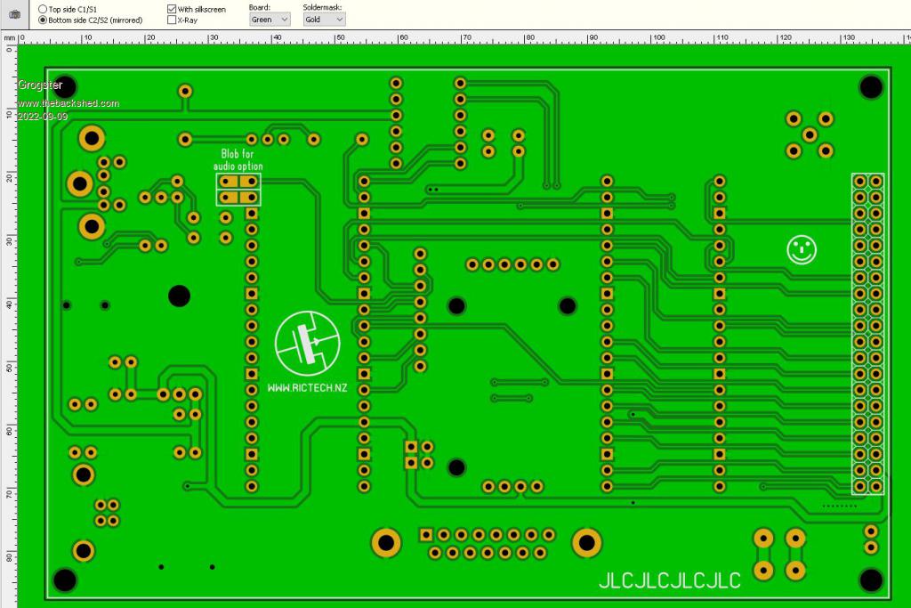

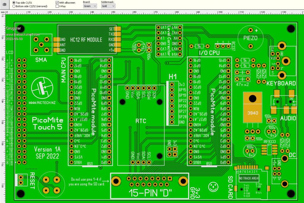

Hi all.
This is a board based loosely on the Explore-100 board, but using a couple of cheap PM modules due to the rarity of the E100 PIC32 chip these daze...
The main PM and the I/O PM are linked using COM2 on both modules.
This allows you to write your own way of handling things from module-to-module, and the native COM port buffer can keep track of commands in both directions from or to either module, and you can just deal with anything inside your main loop.
IRF9333 MOSFET for polarity protection was taken across from the E100 design, then I changed the DC input to a type-B USB socket, and so it becomes irrelevant due to the USB socket being idiot-proof, but I forgot to remove it before ordering some prototype boards.  I will remove this SOIC for any future version of the PCB.
Each PM module can have its own SD card.  The main PM that controls the LCD and the touch, uses the SD socket on the LCD module, and the I/O PM module uses a uSD card socket.
RTC module with I2C EPPROM chip, HC12 module for wireless connectivity, keyboard with level-corrector, piezo for beeps or touch click sound, 3.5mm stereo audio jack, and 15-pin "D" socket for the I/O PM pins.  The D socket is placed so that you can still easily plug in the USB cable to each PM module to load the firmware etc.
Board is same size as a standard 5" LCD module, that being 133mm x 84mm
Once the boards arrive and I have built one, I will add more to this thread.
In the meantime, feel free to comment on the 1A design - bearing in mind this is a prototype.  It is unlikely I will be changing this design other then to fix any errors in the layout, but if someone suggests something really useful and easy to change or add....

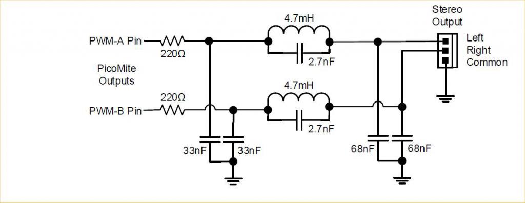

Maybe you should adapt the analog audio output. The E100 circuit for the PIC does not work very well with the PWM output used by the picomite.
You can take the circuit from Peters 1.7 board on the VGA picomite.
I fail to see the second SD card slot.
Edited 2022-09-09 22:01 by Volhout

Something I now do that makes life much easier is to include the OPTION settings on the PCB silkscreen then the board becomes largely self-documenting

This IS the LPF circuit from the PM manual, not the E100 one.
See page 28, PicoMite standard manual, or page 25 of the PicoMite VGA manual.
This is what is on the board.
Unless you were thinking of something else that is NOT in the manual perhaps?
Do share a link if you are.

  matherp said  Grogster
Good idea, I will include that for the 1B.
Posts: 12185
Posted: 12:10pm 09 Sep 2022
  Quote  This IS the LPF circuit from the PM manual, not the E100 one.
That will be updated in the next manual
Note the inductor should have a 20ohm resistance e.g. B82144A2475J000

How many analogue and counting pins come out on the D connector?

@ matherp & volhout - Oh, I see!  I have never seen that circuit.  Glad it will be in the new manual then.  I can find a way to incorporate that I think on 1B.
@ LouisG - Pins GP0 to GP14 on the I/O PM module, are routed to pins 1-15 on the D connector.  Whatever those pins are capable of, the D socket can do.
EDIT: I will make sure I label the D socket pins on the silkscreen in 1B also, along the same lines as Peter suggested with the OPTION commands.
Edited 2022-09-09 22:19 by Grogster
Posts: 12185
Posted: 12:20pm 09 Sep 2022
  Quote  Pins GP0 to GP14 on the I/O PM module, are routed to pins 1-15 on the D connector
That means zero analogue pins - possible a mistake?

Can you add a 3 pin header for AUDIO as I have been waiting ~2 months for that SMD Audio jack from EBAY.  (My order got canceled due to "out of stock" so had to order again, for the curious)

@ matherp - Zero on the D connector, correct.  However, the three ADC pins(GP26, GP27 and GP28) can be accessed on the H1 header, along with ground and 3v3 references.
@ pwillard - Yes, I think I can squeeze that into 1B also.

The one driving the (parallel) SSD1963 has only few pins left. So you need something to expand IO to do anything usefull with the board (except looking the display). The choice to use COM2 for inter(pico)chip communication is logical.

No ground pin on the 15 pin D? Only the shell? Yikes.

My personal choice would have been for a boxed IDC male connector rather than the 15-pin D. They are cheaper and very easy to connect to using either a ribbon cable or female Dupont pins. The box gives some protection against shorts. Very much a matter of taste though. :)

@ vegipete - No need for a ground pin there really.  If you want a positive or ground reference, there are other places on the board such as header H1 or main system ground, and there is a 2x2 header with 3v3 and GND on it just above the D you can tap into, but I have used the shell for a ground on more then a few projects, and NEVER had a problem with doing that.  Ever.  I think the 'Yikes' comment is a little over the top, suggesting that it is fundamentally flawed to not have ground pins on the D.  If I had put ONE ground on the D, someone would have moaned that there should have been two, or three, or 3v3's, or 5v's, or all of the above.....it never ends.
