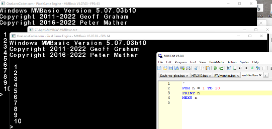

I launch from MMEdit and I get a console window + MMB4W window and the code runs.
If I don't kill those windows after editing the code, launching again from MMEdit gives me another console window but no MMB4W window. Is this just the way it is or am I missing something?
IOW, I have to kill both windows in between edits?

I can open as many MMB4W as I like from MMEdit
It might depend on what the code you are running is doing.

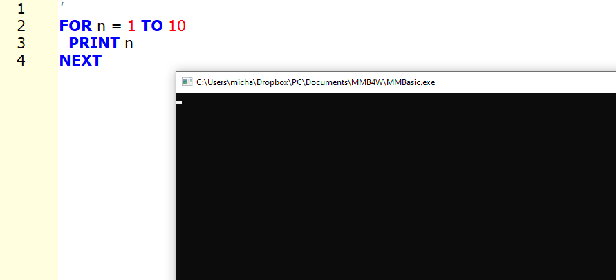

Hmm, now I only get this

I can't think why that's happening.
Could you zip up a copy of your MMEdit.inf file in cace I can see something in your settings.

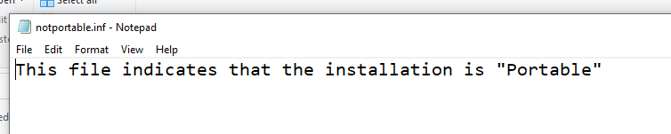

Doesn't exist, Jim.
The only .inf I have is this one:

Help/About will tell you where the data files are kept.
