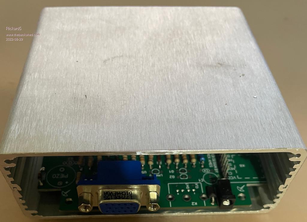

Just waiting on a few more parts from Amazon and Mouser
Posts: 9329
Posted: 11:16am 29 Aug 2022
It's coming along nicely. :) Nice extruded case. I like that stuff.

  Mixtel90 said  It's coming along nicely. :) Nice extruded case. I like that stuff.
Thanks Mick, and Thank you for all your Support and walking me though the Regulator thing on a Remedial level :) 20 years ago I did so AutoCadd Drafting for an Oilfield equipment company that used those Extrusions of all sizes from the size of a pack of cigarettes to the size of Dual 8" Floppies. Anyhow I showed up one Friday with a Case of beer for the Shop Guys Lunch time BBQ, and hit up the shop Forman for Drops (chunks too small to use) and he loaded up a 40 - 50 pound box of assorted sizes, and I been using them up for years, and I'm starting to run out :( but I'm looking forward to Project Apollo, and hope there will be one! We choose to build FAST Basic Computers in this decade and do the other things not because they are easy, but because they are hard. Because that goal will serve to organize and measure the best of our energies and skills, because that challenge is one that we're willing to accept.

  Kabron said  Why so?
Why do I like it?

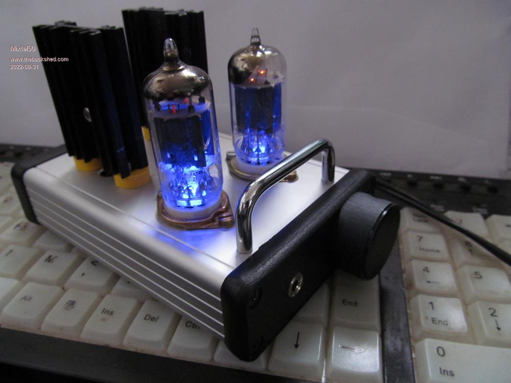

I've used it on a couple of projects, including a valve+MOSFET headphone amp, where it looks really classy! It's nice to use where you need a bit of screening and mechanical strength. It also makes an excellent heatsink, a property that I used on a class D amplifier.

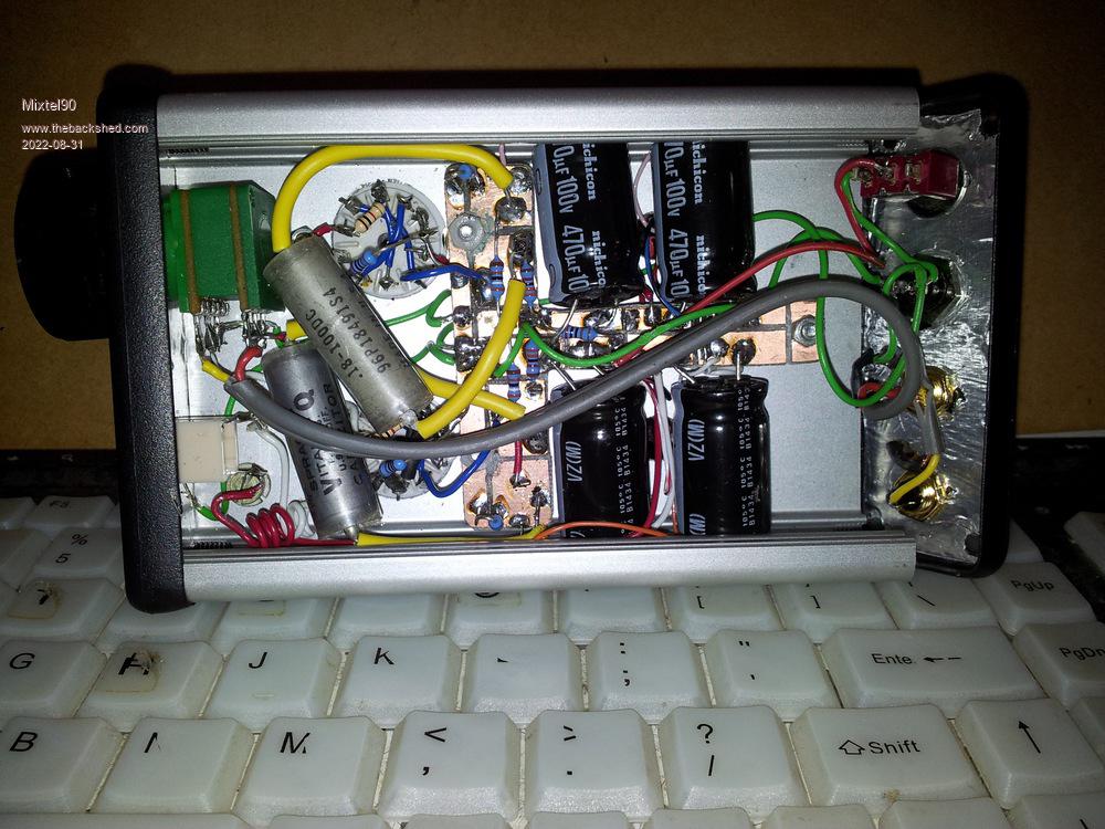

My headphone amp is based on the "Starving Student" design. Circuit
I can *highly recommend* this design. Everything runs in pure class A, so the MOSFET heatsinks are spaced off so that air can circulate. They run quite warm. :) Power is provided by a 48V HP printer power supply.
The LM1117T won't get hot with a 5V supply. At most it's dissipating about 1/3W.

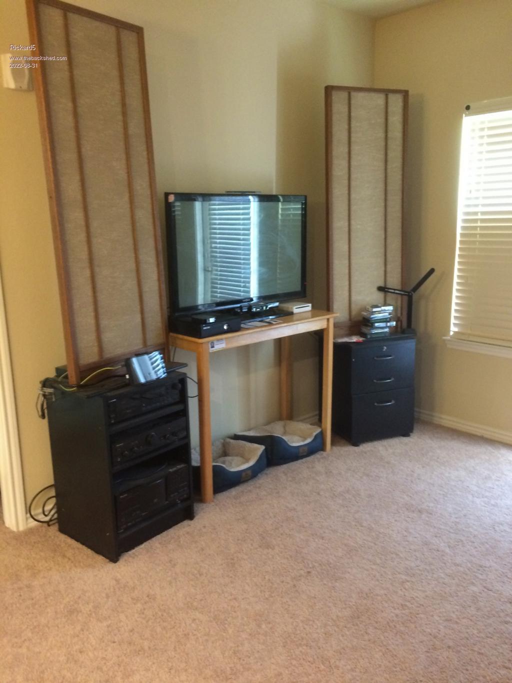

That is cool I'm going to look in to that Amp, here are my Babies (4 ohm Magnepan plainers) I'm currently driving them with a Pioneer elite Receiver and they are Power hungry beasts

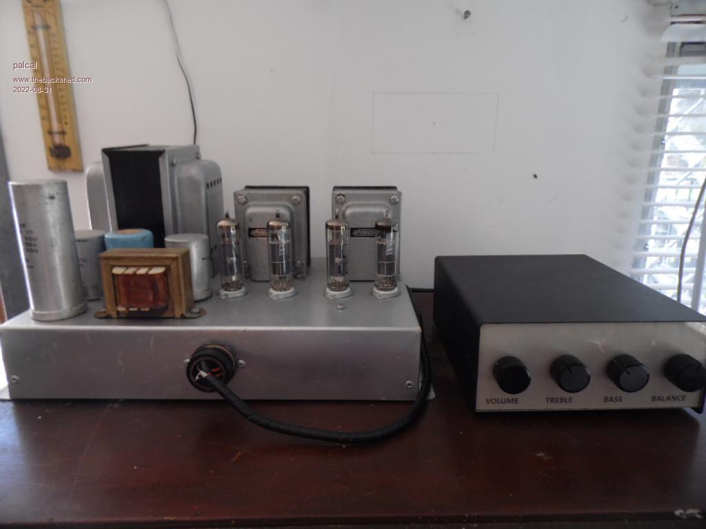

Sorry this is getting off topic, I built this amp. 55 years ago. It had a rebuild a couple of years back to update the caps but still has the original 6GW8 valves.

MMM....  planars... with stereo cats too! Lovely, Rick. :)
Proper Ali and Iron, Palcal. :) At least those valves are still available (although not particularly cheap). So, triode amp, concertina phase splitter then the pentodes in pp at a guess?
I have a couple of Russian directly heated triodes - a bit like small 2A3s but with 6V filaments. They would be nice single-ended, but the iron is *very* expensive now as is the electricity required to run them! The room would be warm though.

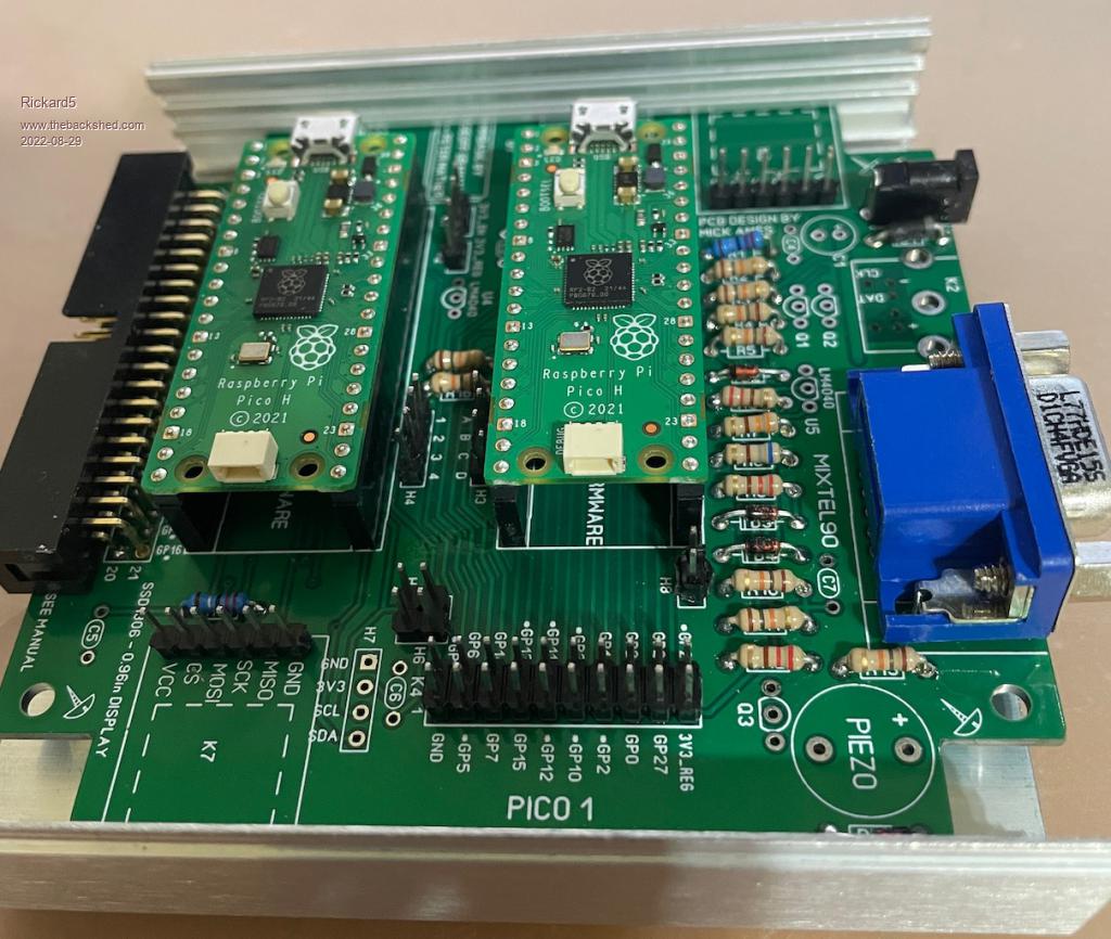

The token on-topic bit:
Rick:
The top ground planes on that pcb is connected to GND, the bottom one is floating. Any sort of fixing that can connect to the top ground plane will connect the case to GND, so watch out for anything that could get shorted, particularly if the board is loose in the slots. Anything already connected to GND is fine, of course, but not stuff connected to 5V or 3V3. :)  Just one of those little perils as it was designed to fit a moulded plastic case.

Rick:

The Token On- Topic Response
Thank you for the Advice on the GND plane, I'm super paranoid about shorts and thankfully the PCB on Gemini is about a mm narrow of the case so I cut a reclaimed PCB to fit the Groove as a carrier board and I'm going to use low rise 3d printed plastic stand offs and Kapton tape as insulator :)
