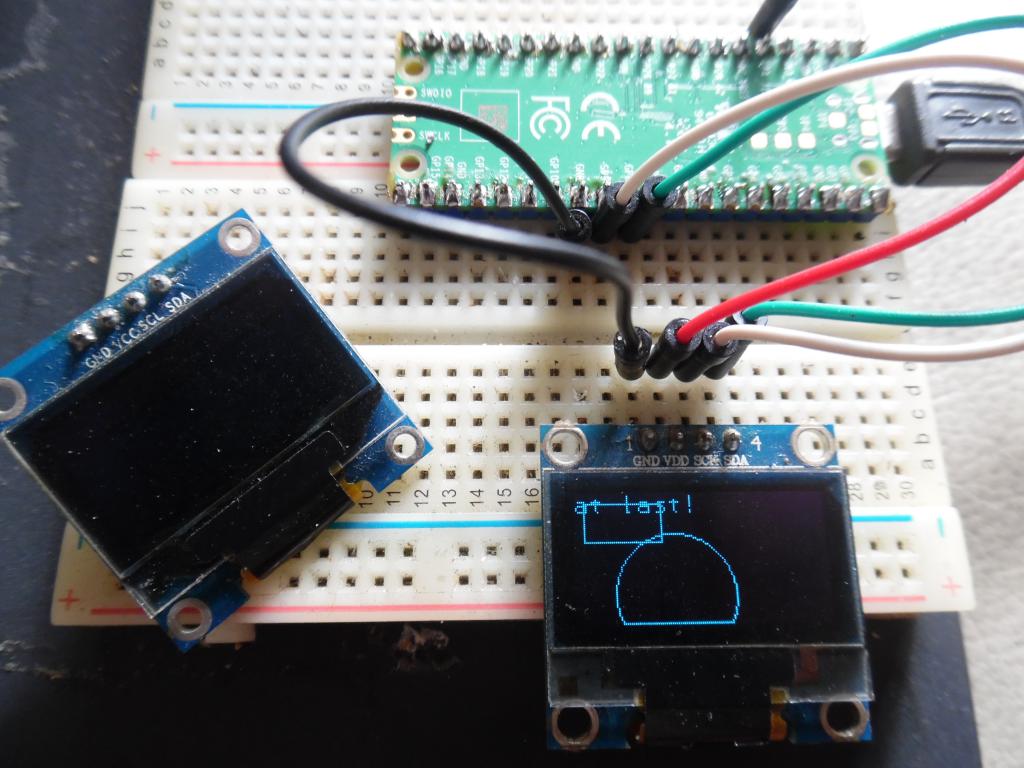

Is there a demo of ssd1306 working with i2c0 scl gp9 and i2c0 sda gp8 please?
I tried option lcdpanel ssdi306i2c, 1 and says invalid option.
I have not used i2c with mmbasic.

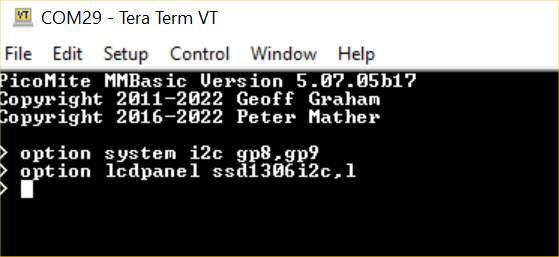

tried
> option lcdpanel ssd1306i2c, L
Error : Invalid Option

> option system i2c gp6, gp7  'no error
> option lcdpanel ssd1306i2c,l

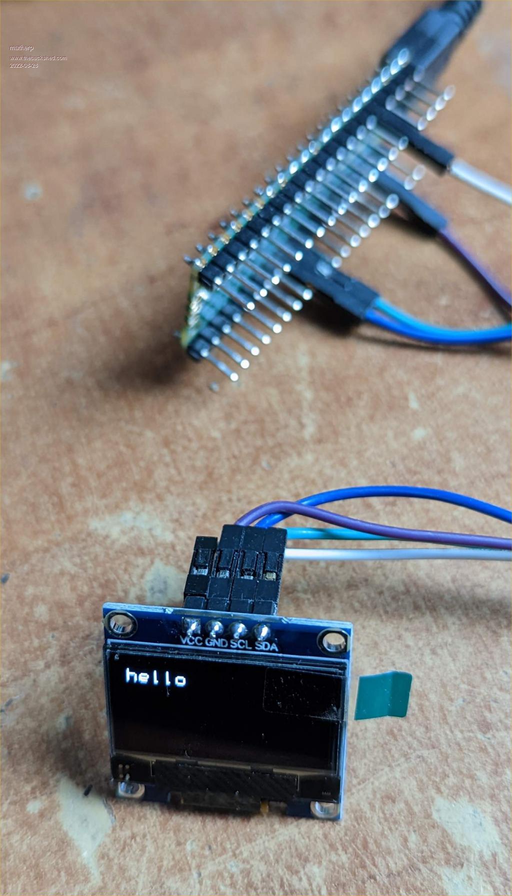

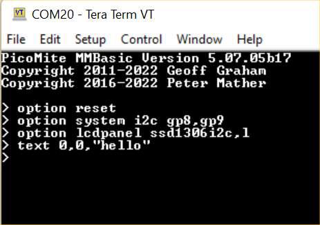

Start with OPTION RESET to clear anything there before. Then use the commands exactly as per my picture. You are using the PicoMite and not PicoMiteVGA firmware? 10K pullups will be fine but are probably already on the SSD1306 PCB

rewired to gp6,gp7
> option reset
> option system i2c gp6, gp7 'gets this far ok
> option lcdpanel ssd1306i2c,l 'error

Posted: 11:11pm 26 Aug 2022
What does ?mm.device$, mm.ver report?
What does OPTION LIST show?

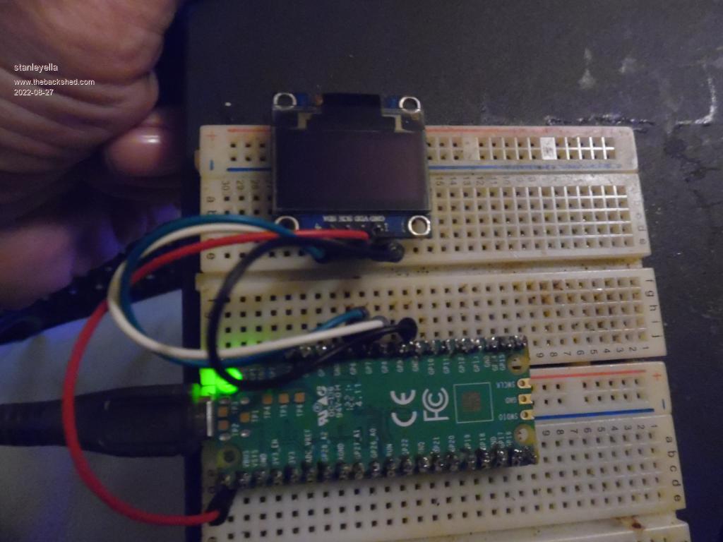

stanleyella
Joined: 25/06/2022
Posts: 2807
Posted: 07:34pm 27 Aug 2022
Mik
testing nothing works with 2 ili9341 that do work
teraterm
> option reset
> option system i2c gp8,gp9
Error : Pin 11 is in use
yawn. forget i2c expanders
