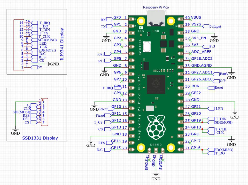

Could someone look over the circuit below and tell me if this is the right settings please?
I tried this with OPTION LCDPANEL SSD1331, RL, gp20,gp19,gp13 and the disply just flashed once so I then tried after resetting the options with my 2.5inch ILI9341 display and am getting nothing at all

I don't think option system I2C is valid using spi.
I used the manual wiring diagram and
OPTION SYSTEM SPI GP18, GP19, GP16
OPTION SDCARD GP22
OPTION LCDPANEL ILI9341, L, GP15, GP14, GP13
OPTION TOUCH GP12, GP11
Page 47 in the manual
I think you want to run 2 displays hence I2C. There are 2 spi /I2C channels and the ili display only could work with spi1 and ssd13xx could use other channel as I2C but like you say how to set it up.

  twofingers said  I would think the displays are SPI.
true- circuit looks spi for both devices.
so not use sda,scl

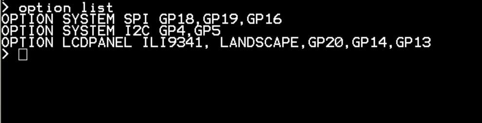

OPTION LCDPANEL ILI9341, LANDSCAPE, GP20, GP14, GP13
Is that correct for the circuit I have shown?
Posts: 6122
Posted: 09:15am 25 Aug 2022
I think it should be
OPTION LCDPANEL ILI9341, LANDSCAPE, GP15, GP14, GP13

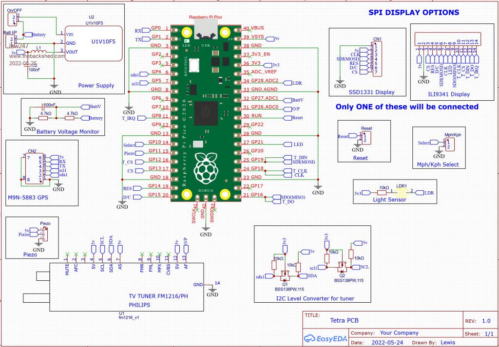

This is a better circuit
The only thing I have connected at the moment is the GPS unit and I've run the i2c detect program listed above
the results are:

I'm not certain my "logic converter" for the I2C pins actually works, it might have fried the tuner or the pico

The datasheet for the QMC5883L shows 2 x 2k2 pullups on the I2C pins. I don't see them in your circuit. Could be worth a try.
lew247
Joined: 23/12/2015
Posts: 1709
Posted: 12:50pm 25 Aug 2022
The qmc5883L works without the pullups, I had it working on a different board

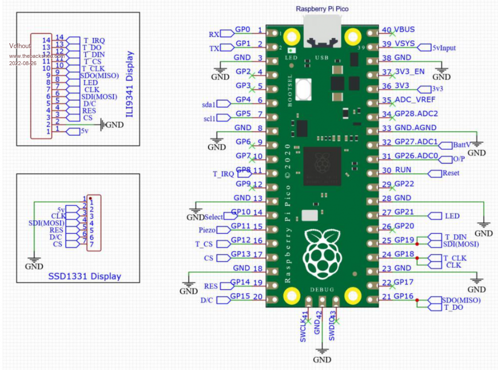

Posts: 6122
Posted: 05:11pm 25 Aug 2022
Hi Lewis,
Touch and LCD share the SPI bus. It is possible that the touch controller (OPTION TOUCH) when not configured correctly, blocks the SPI bus so the LCD wont work.
The LDR will not work. You need to put 1 side to ground, and measure the voltage at the connection between the LDR and the 10k resistor.
