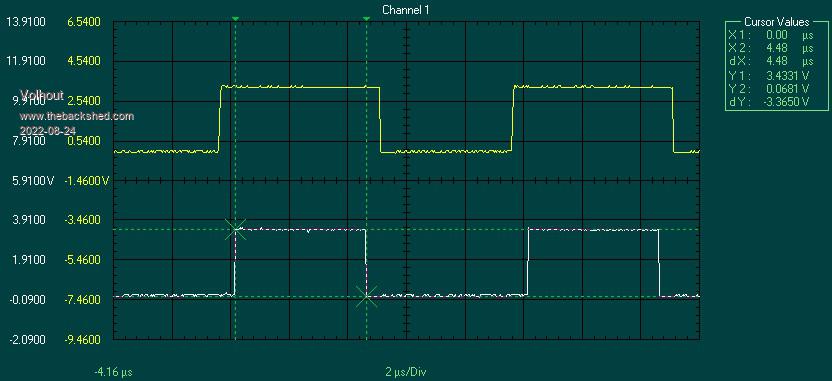

So you need 2 signals that are out of phase, but need a "gap" between them to avoid MOSFET's being ON at the same time. In essence you can use a PWM and drive 2 outputs at different duty cycle. A PWM is essentialy a counter that starts at 0 and counts until it hit's the PWM comparator setting, and than toggles the pin.
As you can see, both signals PWM0B top, PWM0A bottom have a different duty cycle, and this shows as a time gap (at the falling edge). The leading edge of both signals happens simultaneous. If you use these 2 signals to drive 2 MOSFET's the falling edges will be fine, but the rising edge (depending the speed of individual MOSFET's) both could still be conducting (briefly) at the same time.

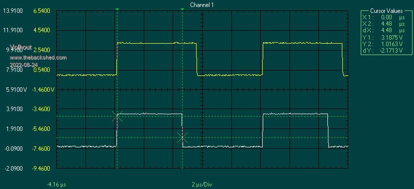

To create a symmetrical "gap" you need to change the PWM operating mode to "Phase Correct mode". The PMW counts from 0 upward until it hits the PWM compare value, toggles the pin, but at the end, it starts counting down again. Hitting the same value again, and toggles the pin again. It is easy to see that when counting up...and down... you need twice the time, so it is essential to double the PWM frequency when using phase correct mode.
In this image you can see that there is a symmetrical "gap" between the 2 PWM outputs.
You force the PWM into "Phase Correct" mode by setting bit 1 in the PWM control register. (see RP2040 manual). For PWM0 that is register &h40050000
Below code demonstrates the behaviour shown in above 2 graphs.

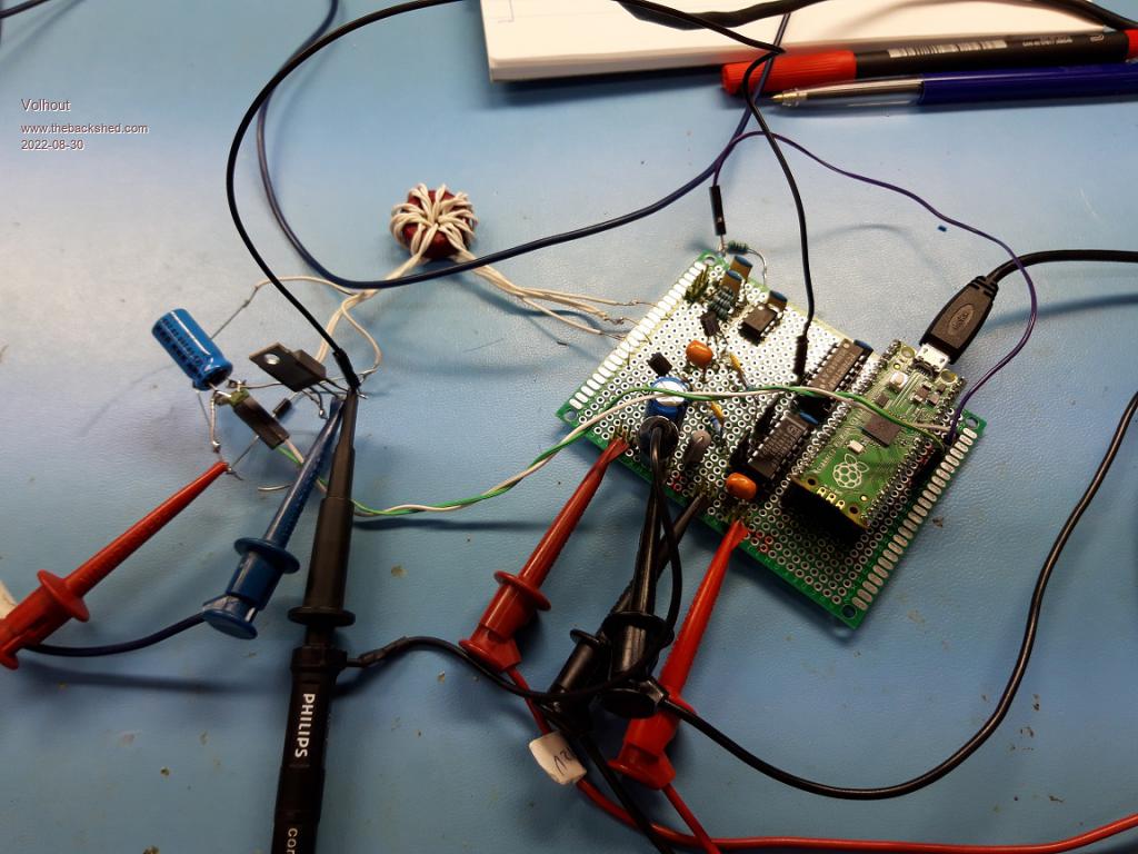

Posts: 6254
Posted: 03:10pm 29 Aug 2022
Picomite does it all.....
Thanks to the phase correct PWM the pico is designing (or tuning) this transformer driver circuit. Currently with 2x 2N2222A, but will change to 2 FET's once the shipment comes in.
The picomite controls (PWM1) the load to the convertor (10mA...600mA)
The picomite drives the 2 switching transistors with phase correct PWM0
The picomite measures input (ADC) and output voltage (ADC)
The picomite measures the current through the switching transistors (ADC).
The picomite does all the math to determine the efficiency of the convertor.
Tomorrow I'll write the tuning algorithm to vary frequency, load, duty cycle, and determine the efficiency landscape (3d graph in excel from CSV data).
Then the setup moves to the climatic chamber to see how things behave at different temperatures.
Anyway, once the algorithm works, I can tune the transformer and FET's for best efficieny.
The only thing I do not have automated yet is the input voltage. Which I may do using serial port. I must have a MAX232 somewhere. The pico can then also control the power supply.
In case you wonder why the wire is so thick for 600mA: it is tripple insulated wire since the convertor must isolate input from output under 12kV surge. I will add surge protection at the switcher transistors.
Edited 2022-08-30 01:13 by Volhout
