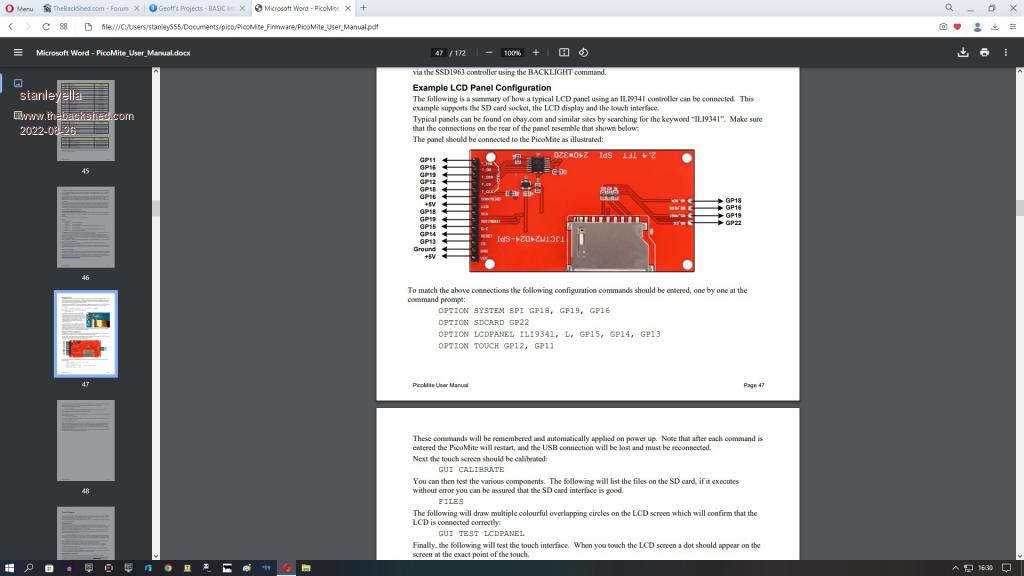

In that manual see image from
page 47

That is the "ili9341 manual". All the pixel, line, circle, box, etc. just work.
MMBasic does not use libraries for lcd devices as Arduino does... or gcbasic, which calls them include files.
I found if I wired the ili9341 as the instructions correctly (we all make mistakes :) )
then read the manual carefully, it works very well. IMHO the mmbasic graphics for this lcd are excellent. It is fast for spi. Hope you get it working.
