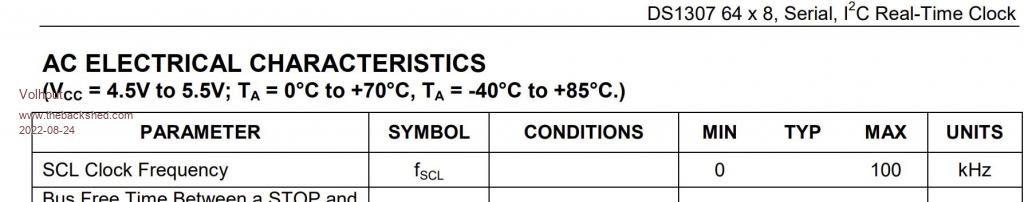

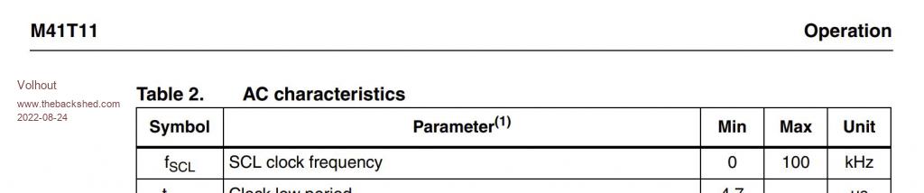

Posts: 6254
Posted: 08:48am 24 Aug 2022
Maybe this is something for the picomite bug list.
The system I2C port needs to be 100kHz -or- the user manual must be adapted.
The DS1307 and M41T11 RTC chip cannot run at 400kHz. It's maximum is at 100kHz

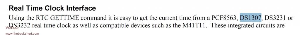

Posts: 6254
Posted: 06:27am 25 Aug 2022
  lizby said
  DrifterNL said
  Bleep said  Hi Volhout,
Simple answer is to use the 3231, dirt cheap.
https://www.ebay.co.uk/itm/224582710859?hash=item344a2c364b:g:1D4AAOSwU-ZhIzu4
About the 3231 module in the link.
Even simpler and smaller aliex DS3231 module
A number of Mick's Picomite PCBs (and those of other people) use these.
I appreciate your suggestions, but my point is that we have a mismatch between the user manual, that advocates a DS1307, and the firmware that will not work with a DS1307. Geoff and Peter have to align user manual and firmware. Same for the M41T11 chip.
The DS3231, DS3232 and the PCF8563 are fine
