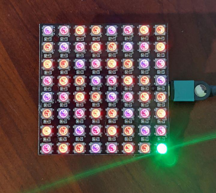

I am using a Songhe 8X8 64 Bits 64 X WS2812B panel (I love these BTW, they are cheap and work great). I run the following code:

Using (Non-VGA) V5.0704 this works great, sets all LEDs off
Using V5.070517 this sets the first ws2812b of the 64 LED string to bright green, all others to off.
This is independent of any data in buffr().  All my display programs work fine with '04 but with '0517 have bright green on first LED only.  I wrote the above code to isolate the problem.  Problem repeats with 2 different Pi Picos and with 2 different Songhe.  Problem repeats with power cycling and Tera Term reload and laptop reset and on battery with autorun on.

Thanks for the info. Was caused by me trying to save RAM by leaving the WS2812 code in flash. Unfortunately this causes the timings on the first LED to go wrong as the code gets cached - will revert in the next beta
