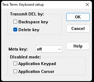

^? isn't special but ^ is often used to indicate 'control' control-H works as destructive backspace. control-? does nothing.
Any standard terminal program will have the backspace key programmable.
In Teraterm, it's the delete key that gets programmed:
Good luck with trying to get them to change it.

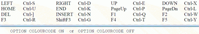

When working in the Program Editor on a PicoMite while connected with Serial_Term it's helpful to have these codes from the manual handy, since the chromebook doesn't have function keys:
