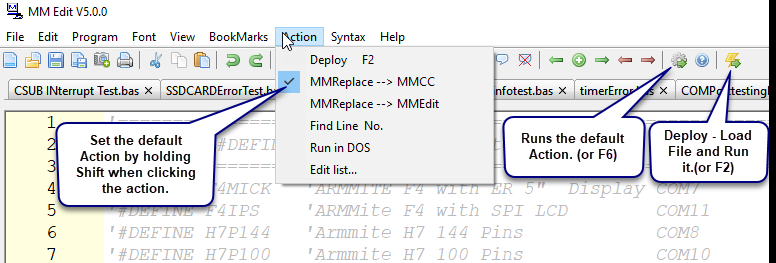

Integration into MMEdit5
Three items are added to the Actions menu.
MMReplace --> MMCC   F6
This calls MMREPLACE.EXE which processes any DIRECTIVES, deletes comments, blank lines and loads the program via MMCC (Maximite Control Centre)
MMReplace --> MMEdit
This calls MMREPLACE.EXE which processes any DIRECTIVES and sends the code and comments back to MMEdit as a new file.
Find Line No.
This calls FINDLINENO.EXE which prompts for an error line no to be input, and this line is then located in the original source file, taking into account comments and directives which were not sent as part of the loaded code. (This is done via sending keystrokes an does not expect SUBs/Functions to be folded)

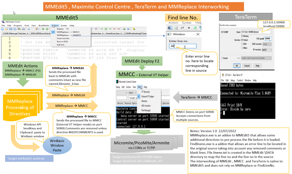

MMEdit5, MMCC, TeraTerm and MMReplace Interworking
This diagram shows the relationship of the various components.
