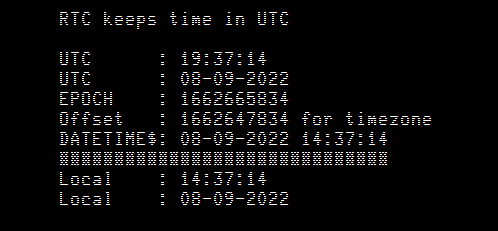

Still goofing around with a clock.
And now that I'm a bit more comfortable with MMBASIC and having found EPOCH() and DATETIME$()... my code just got a LOT simpler.
This is only a couple of lines of code to create this.
So... THANK YOU!

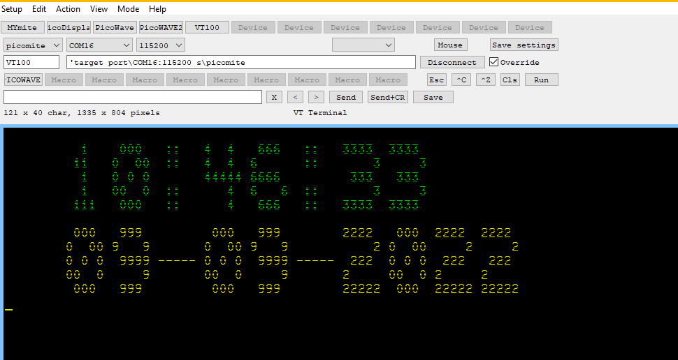

More progress...
