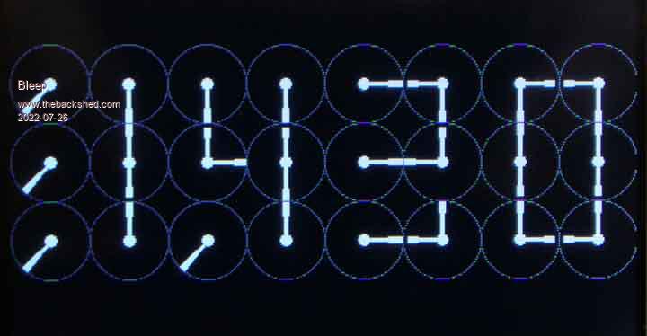

Attached is my implimintation of a ClockClock24, this is currently running on a PicoMite with a 480*340 ILI9481 LCD display, for which it has been optimised.
I am running the Pico at 378MHz because this gives the smoothest screen updates, it works fine down to around 126MHz, but the updates get more steppy. The animation is running at approx 5Hz, but will go faster if required by reducing the value of 'Const update' in the drawing loop. Otherwise if anyone has some ideas about improving the animation calculations, lots of big arrays to add or multiply, or more efficient ways of updating the display then please comment.
Looking at it now I should have done this a month earlier and entered it in the competition, :-) hindsight is a wonderful thing. :-(
Regards Kevin.

I have created a video of the ClockClock moving, if anyone interested, my next job is to add some of the symetrical animations. :-)
ClockClock in operation.
Regards, Kevin.

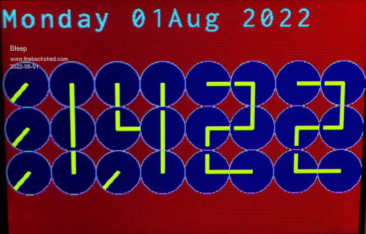

Changed the colours to Blue background and Yellow hands, looks great.
I tried putting the Date at the top but obviously it keeps getting erased.
Posted: 12:41am 31 Jul 2022

After playing with the COLOURS (thanks Kevin you have put a lot of thought into this)
I love the Red background with Yellow hands and black outline.
IF you are after suggestions you could add a DS18B20 and use the top line to display temperature maybe with smaller circles. And Maybe the date on the bottom area but then you will need to cater for differences in display formats eg DD/MM/YY, YY/MM/DD etc etc.
You could also just update the number that is changing, maybe the flicker wont be as obvious then, however I feel that you will lose some of the impact that the entire screen changing gives.

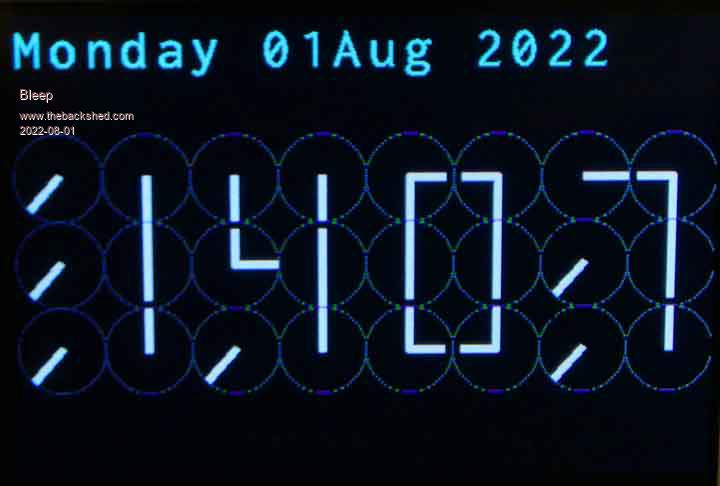

Ok an update, which I think has improved the animation quit a lot, there is still a sort of ripple, but I don't think I can improve on this. I have added the date which can be UK/US there is a constant called 'uk'; all the various colours are also defined in the same place and should be fairly obvious.
Because of the improvements to the animation I have gone to rectangular hands, which now animate in 2 Degree increments; at 378Mhz, I'm using a pause value udanm=80, 40 @ 276Mhz and 0 @ 126Mhz, this makes the animation last approx 30 seconds, change as you wish.
I have added a brightness subroutine, which allows touch screens to alter the brightness, Top Left for up, Bottom Left for down. This subroutine will also reduce the brightness at dusk and brighten it up at dawn, though you will need to alter the hour values depending on where you are, it also goes very dim at 11pm, sleep, because it's had a hard day. ;-)
That's about it I think.
Regards, Kevin.
