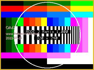

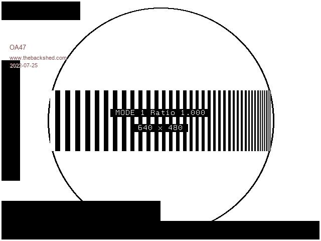

Here is a modified program that was originally written by TassieJim for the Colour Maximite 2 that has been adapted for the Pi Pico VGA platform. A lot of the original features have been removed due to the limited colours and modes of the Pi Pico VGA.
I originally wanted to use it to adjust the trim pot on the resistor/diode form of the VGA circuit but it has been superseded by the 4 resistor circuit. Here it is with the BMP shots.
Thanks again Jim

Thanks OA47,
It was great for testing my PicoVGA board.
Martin H.

I don't think the trim pot version has actually been *replaced* as such, it's just that it isn't needed to get acceptable colour on *most* displays. I suspect there are displays out there (particularly old ones or re-purposed TVs) where the "75R" input isn't 75R or varies between colour channels. In cases like that the trim pot version would be far more likely to work first time without having to play with the resistor values.
Thanks, OA47 (grand old diode!), I'm going to add that to my armoury. :)
