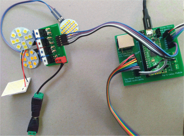

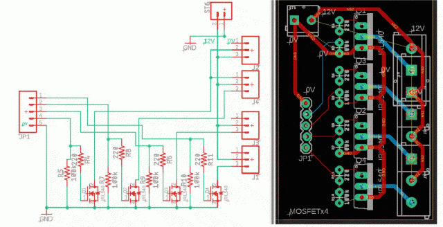

Should anyone have a use.
(12V LEDs and IRL540 MOSFETs)
Gerbers:

If I were to have any niggle it's that a couple of fixing holes would have been useful, even if the board had to be a little bit bigger. You could probably get them in on opposite diagonals anyway. I'm not sure what distance you have between the mosfets, but I suspect those tabs are connected to Drain. You need to be a little careful that they don't short together. Otherwise, I like it. :)
Posted: 02:26pm 07 Jul 2022
Thanks. Mounting holes will be good when I figure out where and how I'm going to mount it. I would have thought the tabs were connected to source. I'll check.

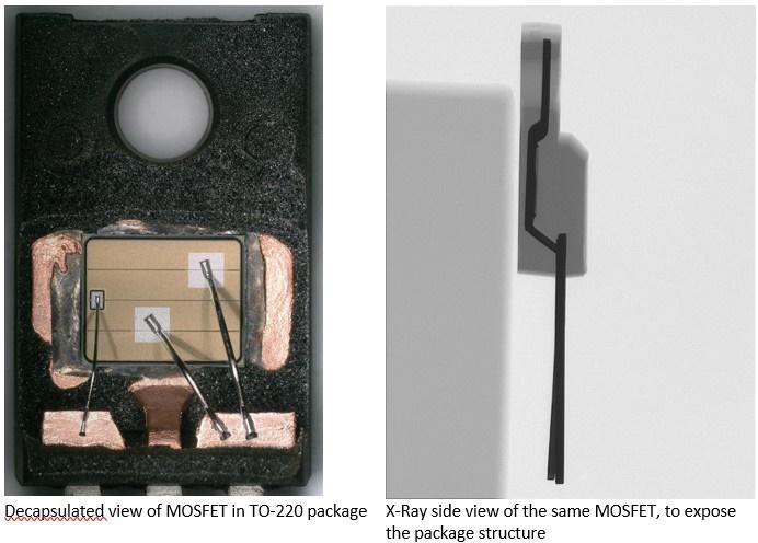

On TO-220 cases... the center PIN is attached to the metal TAB.

I've been having a search... What the tab is connected to seems to be secret. lol
No mention on the Vishay Siliconix, Fairchild or International Rectifier data sheets, but Infineon say it's connected to Drain.

  pwillard said  On TO-220 cases... the center PIN is attached to the metal TAB.
+ and + Infineon
On my Chinese IRL540s, center pin (drain) is connected to the tab. So Mick's advice about spacing is appropriate.

Posted: 06:37pm 07 Jul 2022
It comes down to the mechanicals of the PART and the way the DIE gets manufactured.
