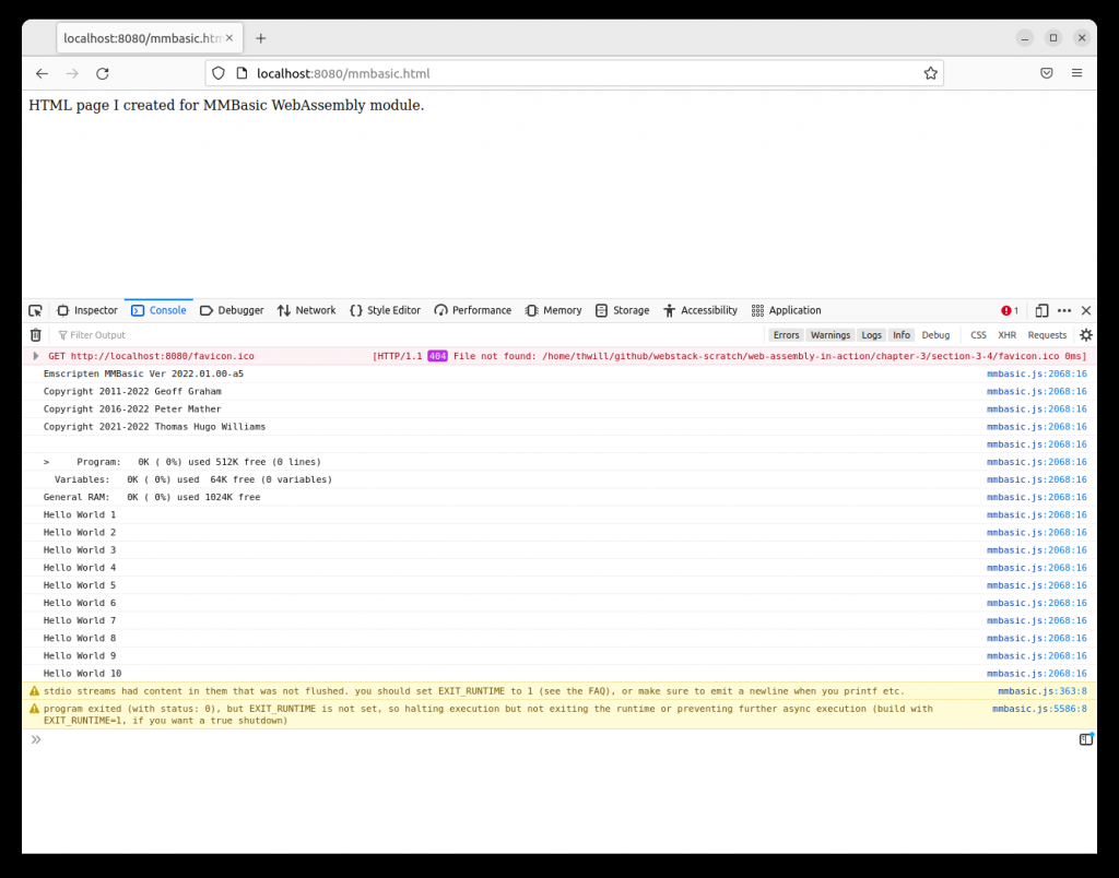

A long way from being anything useful, and I've no idea where I'm going with it (probably nowhere), but this is MMBasic running as WebAssembly within Firefox:

Nice
I was going to try Web Assembly but at the time the libraries had a few holes and it would crash on some numeric work
Keep going and keep us posted please !

Any update on the Web Assembly.. ? Intriguing..

  zeitfest said  Any update on the Web Assembly.. ? Intriguing..
Hi @zeitfest,
Thanks for your interest.
This is a "self-directed learning" project that I started for the day-job. MMBasic was just a conveniently large piece of C code to work with and had the great advantage that my employers wouldn't then try and sell a half-baked learning exercise as if it were product.
At the moment it is in mothballs whilst I deal with other work priorities. Before mothballing it I had reached something of an impasse as the event loop model that is used for writing Web Applications is incompatible with MMBasic's busy loop. Basically in a single-thread once MMBasic starts running there is no way for the Web Application to render output or capture input. By putting MMBasic into a worker thread you can theoretically deal with the output problem by sending messages from it to the main render thread, but MMBasic's busy loop is still incompatible with the main thread sending input messages to the worker thread. Barring a rewrite of MMBasic's busy loop I think the way forward is using a JavaScript SharedArrayBuffer to communicate between the main and worker threads, but historically these were a security hole and whilst I believe most of those issues have now been worked out, their use may still require explicit opt-in by the user/browser (and possibly the website serving the page).
Hopefully I'll get back to this some time in the near future.
