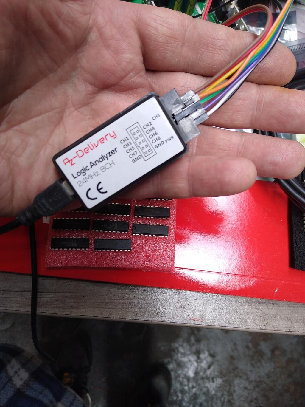

  robert.rozee said  i use one of the us$10 saleae clones attached to a PC which performs admirably as an 8-channel 20Mhz analyser.
Best investment I ever made. The latest Saleae software may no accept the cheap chinese  clones, but slightly older versions do. Also on Linux (32 and 64 bit). And when you are hunting for artefacts, the Saleae UI (the way the app works on browsing data) is far better than any MSO scope.
Edited 2022-07-05 16:24 by Volhout
Posts: 9329
Posted: 06:53am 05 Jul 2022
+1 for the el-cheapo clones of Saleae logic analyzers. An excellent bit of kit and more useful than a scope for a lot of stuff (particularly chip addressing and serial comms).

We talking about this thing?
I grabbed one, thinking I needed it but had solved the problem before it arrived.
What's the best software to get?
Craig

Posts: 6254
Posted: 09:47am 05 Jul 2022
@Craig,
Yes, that is the thing.
Software: 1.1.34
I know this software works with the unit you have. The later (1.2.x) versions, somewhere there is a change that does ot support the cheap chinese stuff anymore.
