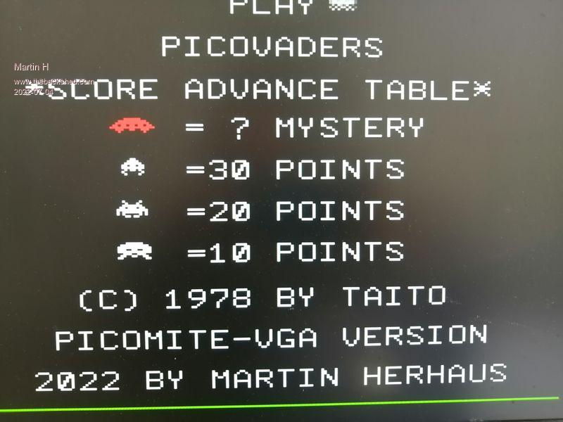

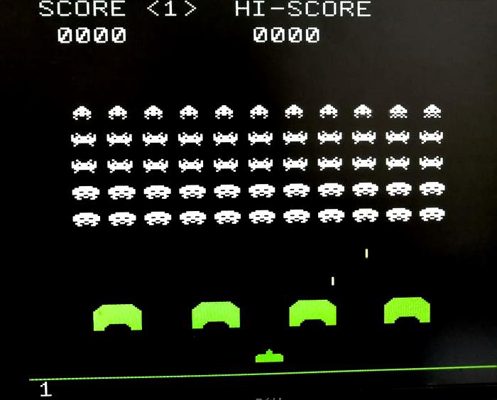

My first try of a complete Game in MM Basic on Picomite VGA
Use Cursor Keys to moce and Space to fire
If one would extend it by Joystick - Routines, you are very welcome
PicoVaders.zip
Chears, Martin

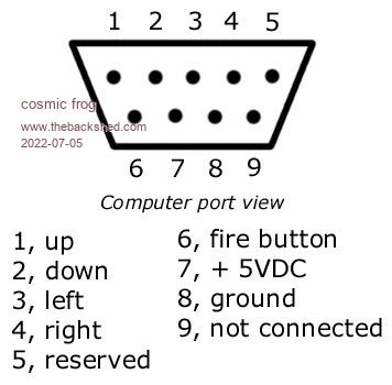

Atari joystick pinouts.
Posts: 4410
Posted: 10:02am 05 Jul 2022
  cosmic frog said  Atari joystick pinouts.
That's correct and matches the layout of the PicoGAME VGA controller ports, but the question here is about the pins on the Pico, not the pins on the controller port - see the schematic linked above.
Also note the Pico will be driving the joystick at 3.3V not 5V, apocraphally that still works - I can't personally confirm as my AliExpress (clone) Atari joysticks are still in their packaging.
Edited 2022-07-05 20:03 by thwill
cosmic frog
Joined: 09/02/2012
Posts: 311
Posted: 10:20am 05 Jul 2022
If the joystick only uses U,D,L,R,Fire all the joysticks I've seen don't need a voltage.
The ones that do need a voltage are those that use extra buttons and usually have some kind of shift register inside.
Dave.
Posts: 4410
Posted: 10:25am 05 Jul 2022
  cosmic frog said  If the joystick only uses U,D,L,R,Fire all the joysticks I've seen don't need a voltage.
Dave.
ACK. I was only pointing it out because your pinout showed a 5V pin, whereas the same port/pin on the PicoGAME VGA is at 3.3V.
