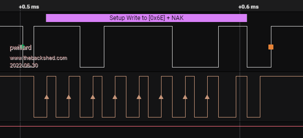

SO I'm reading their page... I can see the device shows up at &H37 with the I2C scanner... but the DOCS and examples say WRITES are &H6E and READS are &H6F so its using that "shifted I2C" stuff.  Ok, I can try to deal with that...
So... after I2C OPEN 100,200
I send  "I2C write &H6E,0,2,&H01,&H01" a supposedly valid command to start playing track 1  but... I only get...
And I don't know why?

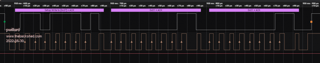

When I right to &H37... I looks different... still doesn't work.

I2C is silly in this respect the 7-bit address i.e. 37 is actually the left most 7 bits. The LSB is actually the read/write bit. In your example just use &H37 for both read and write and the H/W actually appends the correct LSB

Your second trace looks completely correct. The I2C command has transferred properly. There may be other initialisation you need to do (set volume?)
To confirm the command is working check MM.I2C after the write command

And then just like that... it actually started working.  Led astray by the examples.
And yes, apparently one of my tests set volume to 0
