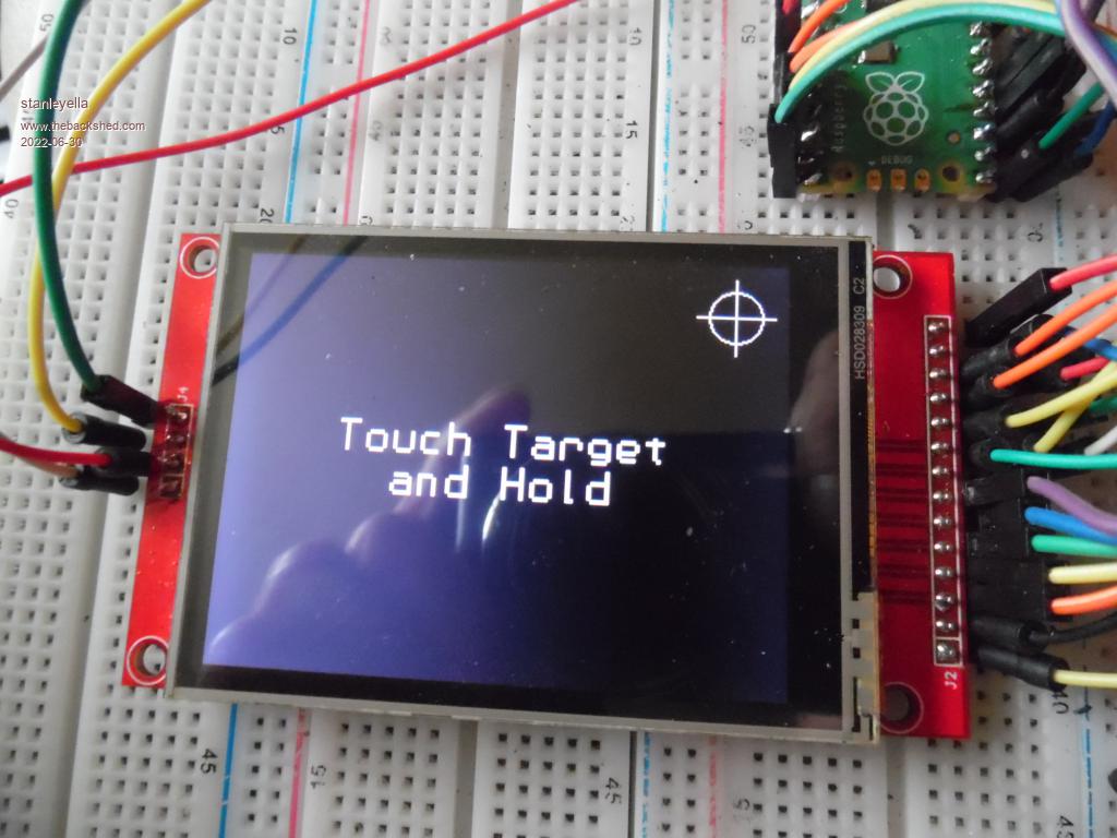

Hi. I just bought a rpi pico and have tried 4 ILI9341 glcds using picomiteV5,07.4.uf2.
The test lcd display displays coloured circles.
The gui calibrate either displays a target top left but touching it does nothing or on another display touching the first target draws another target top right and touching that print error touch hardware in the terminal.
Any issues with ili9341 touch screen?
cheers.

  Quote  It detects the first calibrate target then the next then fails??
This because it is seeing the same coordinates for both. i.e. it isn't reading properly. Check that SDI(MOSI) is connected to T_DIN and SDO(MISO) to T_DO and SCK to T_CLK. Then all these should be connected as per the OPTION SYSTEM SPI command. If it responding to a touch then it is seeing T_IRQ but check T_IRQ and T_CS are specified correctly and the correct way round in OPTION TOUCH.
The ILI9341 code has been around forever and is completely reliable so it must be a wiring error
Make sure VCC is connected to 3.3V and not 5V

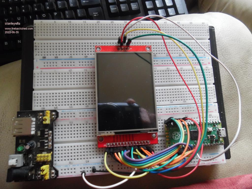

I wired the sd card slot for the ili9341 and it reports no sd card which is ok as no card inserted.
matherp my config is the one in the manual.
lcd graphics ok , touch not ok.
