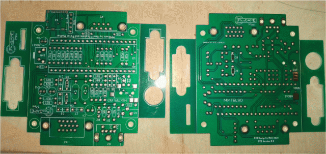

My PicoGAME Mini PCBs arrived today from JLCPCB. 17 days, slow boat, not bad.
I will mail one free to the first three people in North America who PM me with their street address.

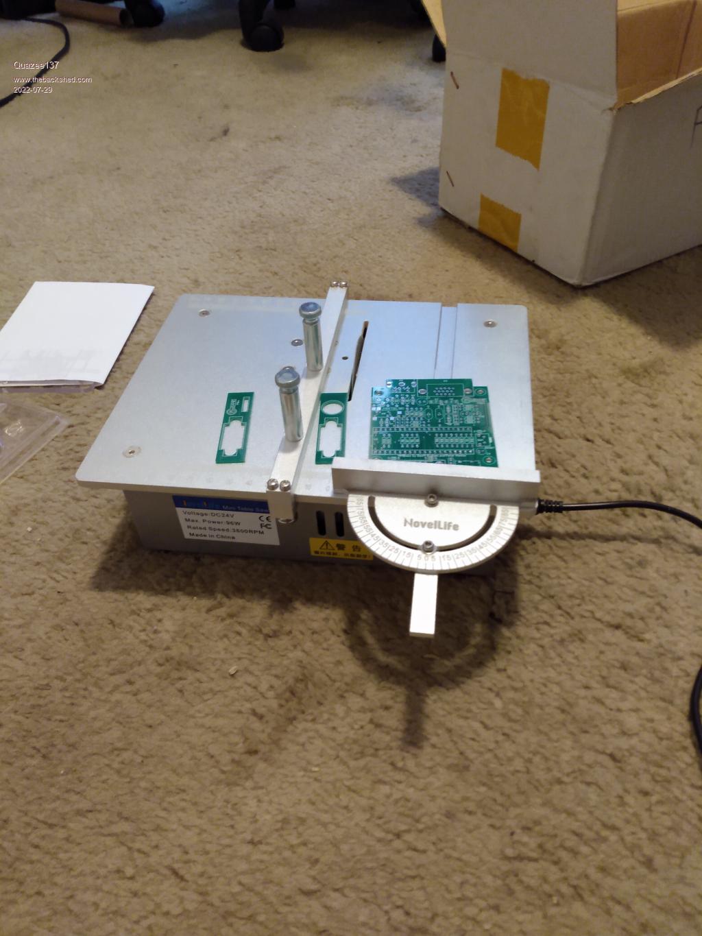

Question: are the end panels supposed to snap off or do I need to cut them (I have a bandsaw)?
Lance
Edited 2022-07-12 10:13 by lizby
Posts: 9329
Posted: 07:05am 12 Jul 2022
I couldn't get them to be snap-off for a couple of reasons. If you mark something as snap-off it's charged as an extra board unless it's identical to the rest, so that would have been the cost of three boards. Also, for snap off designs you have to leave waste areas that are big enough for the clamps and I've used virtually all of the available area for a cheap board.
A bandsaw would be lovely but I've not got one. I do have a sharp craft knife and a 4in vice though. :)
From the doc:
  Quote  The PCB is supplied with the front and back case panels attached. It is, of course, necessary to cut these off. I find that the best way is to put a panel part into a vice (I use some pieces of aluminium angle in the jaws to give some protection as you need to grip it quite tightly), with the top of the jaws along the cutting line. Then score several times with a sharp craft knife on both sides, using the top of the jaws as a guide. I then push the pcb over using a piece of wood and it will snap along the scored line. Clean up both edges with a file (Warning! Fibreglass particles are an irritant - at least wear a dust mask!) then do the other side.
(This is the bit that makes me apprehensive, when one of my designs gets built for the first time and someone else is the guinea pig! Some things, like the cut-outs for the sockets, are not easy to sort out in SL6. I can draw them in CAD, but SL6 can't import any sort of CAD files. It is missing simple tools that would make it even a half-reasonable general purpose CAD.)
Edited 2022-07-12 17:28 by Mixtel90

  Mixtel90 said  A bandsaw would be lovely but I've not got one. I do have a sharp craft knife and a 4in vice though. :)
Craft knife and PCB in vice would probably make a cleaner cut. I probably won't be putting it a box though--nothing else I have is in a box. Even my CMM2 has always had the top off. I do appreciate the fact that you make them to fit a box, though.

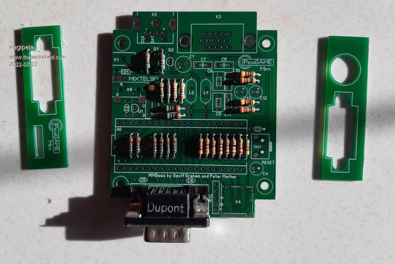

Mick very generously sent me one of these, which I have successfully built & yes a craft knife & a vice worked very well, though you do need to really work at it with the knife, before it'll snap off nicely.
Regards Kevin
Posts: 9329
Posted: 08:22pm 12 Jul 2022
On the later boards I'm removing the ground plane copper from both sides of the end plates. It eases the fitting a little and should make the boards easier to score as, at worst, only the very edge of the copper will be being cut. It'll reduce the strength a little, but as the panel is completely gripped by the vice jaws (and I've arranged the panels to have maximum width at the cut line) I don't think there'll be a problem.
