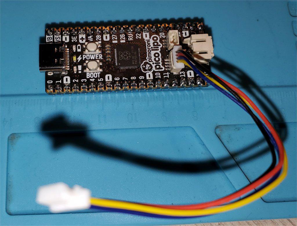

Pimoroni makes a version of the PICO board with a few added features.
Pimorono PicoLipo
Onboard Power on/off switch
ONboard lipo plug for 3.7V lipo with charging
Onboard QIIC I2C connector attached to pins 4 and 5
The problem is... if I load *any* version of the Picomite UF2's on it... the immediate interpreter is S L O W.

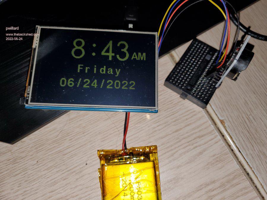

Hmmm,  Actually... there does seem to be some impact on program execution...
I create a CLOCK (based on the sample from the manual) I have an RTC connected as well as a Waveshare res-touch 3.5" display... and with no added delays, just testing if TIME$ changes between loop iterations... and only updating the LCD if seconds are different but, the SECONDS will pause and then jump roughly about 4 seconds at a time.
Oddness.  I mainly wanted to use the PICOLIPO as a battery Backed up alarm clock with LCD display... the LIPO board has a very handy QIIC connector for the RTC... so no SPIKEY PICO is needed.
Note: the pausing is intermittent... sometimes it will update seconds for 5 or 10 seconds as expected, then miss any number of seconds... and on and on... random.

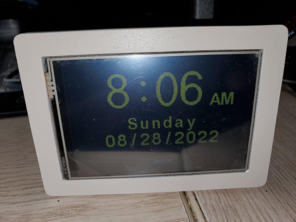

Anyway... When I finally figure out how to make a decent GUI with MMBASIC... I'll post some code and details about my project.  I'm learning all this Gui/Touchscreen stuff in a trial-by-fire.
My goals for the project include having it play a WAV file or files (that I can actually hear)  as an alarm.  And DS3231 seems to keep a pretty good time reference.
The 3.5" TouchScreen is really nice... even if it can't talk back to the Picomite.

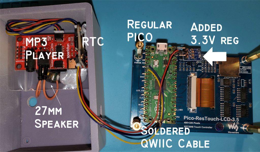

What I liked about the PICO LIPO was that it had a built-in, Lipo Support with charging and a better (quieter) power supply, and a built in QWIIC plug but these differences seem to all add up to an ultimately bad performance.  The PICO LIPO often would have this behavior where the ">" response is very slow... sometimes 3-5 seconds.  ...And this slow response is likely what is making MMCC and MMEDIT sessions go bad. (due to extra memory maybe -16MB-, no clue)
So, to see if this was really the case... I cobbled a QWIIC connector onto a regular PICO and added it to my circuit to replace the PICO LIPO.
Note: Unlike the PICO LIPO, the regular PICO has a very noisy power supply so the MP3 player now had an annoying whine while playing audio... so I needed to also add a 3.3V linear regulator to the 5V supply and it was quiet again.  PICO LIPO did not have that issue.
So yes, PICO LIPO (for ME) has issues being a reliable MMBASIC device... though it worked seemingly as expected until I updated FIRMWARE and MMEDIT versions to the most recent... once the updates were done... it was having issues similar to the issues I experienced when I first started using it.
I'm back to using a regular PICO with some extra stuff tacked on.

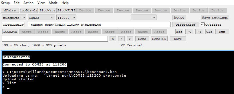

Using the updated MMCC...   it just fails differently on deploy now... I no longer see an attempt... no "NEW" or "AUTOSAVE" statements show up... so that doesn't seem to help. No upload happens and I eventually get the ">" prompt back.
The only fundamental difference I see between a standard PICO and the LIPO unit I have is that the memory is 16MB using a WINBOND 25Q128 chip.
Schematic

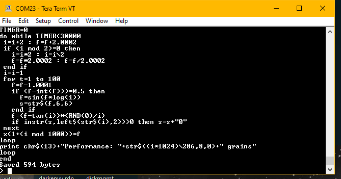

As I mentioned.  Teraterm works with "new" "autosave" and "paste buffer" upload.

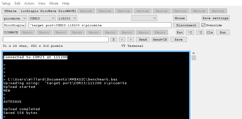

Here is an observation though...
If I cycle power on the PicoLipo...
then use TeraTerm to perform an autosave upload of the benchmark code and press CTRL-Z to save it, I get the ">" prompt back... and it's ZIPPY again... no delays.
If I run the benchmark and CTRL-Z to exit the program... it's still giving fast response.  If I enter "NEW", I'm back to 3-5 second response on the ">" prompt.

Teraterm works as expected when using the AUTOSAVE and the CODE PASTE method... TT must tolerate the delays (I GUESS).  MMCC however, just seems to give up.
I'm assuming it's related to the long delay response on the ">" prompt. That has been either Fast (normal, under the right conditions) or Slow when it's misbehaving.
If there are NO PROGRAMS in memory (IE; a NEW command was issued, the slowness begins). if ANY program is in memory, (IE. use edit to create a single line of code and the F1 to save and execute) the prompt returns quickly to all subsequent commands.

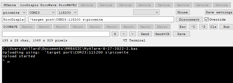

So MMCC issues the NEW command before an AUTOSAVE... and thus the "slow prompt" issue begins.  Flipping the USB-C... no change.
So, my testing now shows it seems to be very related to issuing a "NEW" statement. And it ONLY starts working right if I use the EDIT command and let's say I enter [ ' a remark ] and press SAVE...  Any Immediate mode commands (even the same 'remark') won't fix the behavior.
Edited 2022-08-30 23:29 by pwillard
Posted: 01:51pm 30 Aug 2022
So is it MMCC rather than the Pico?
