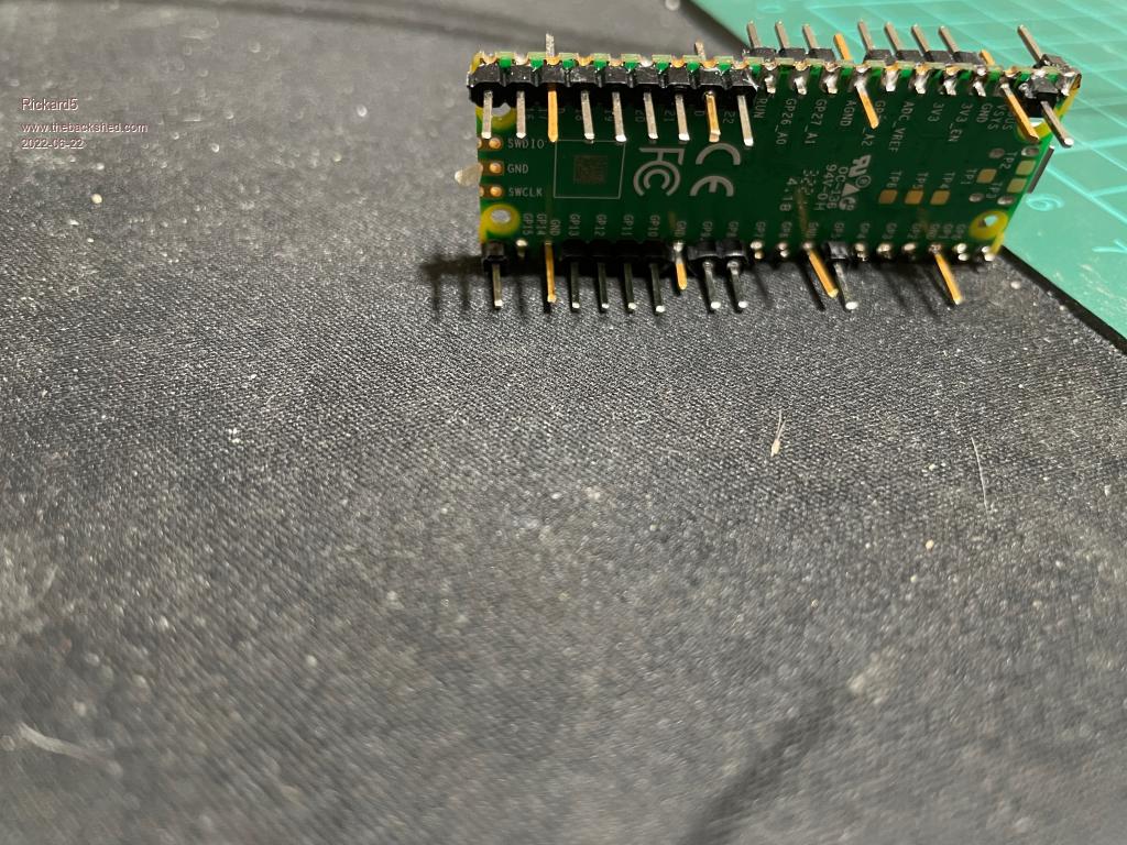

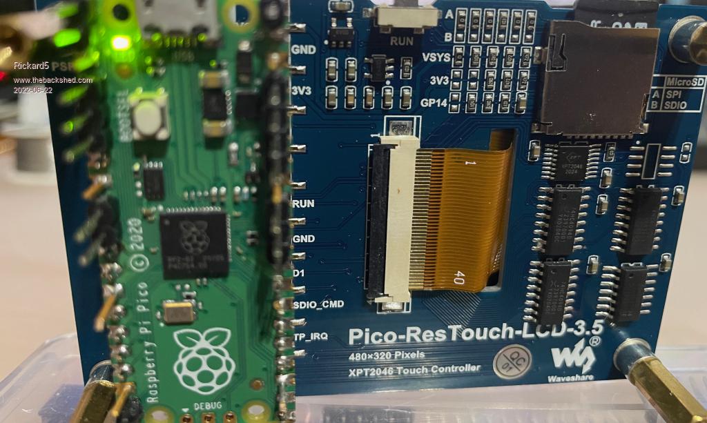

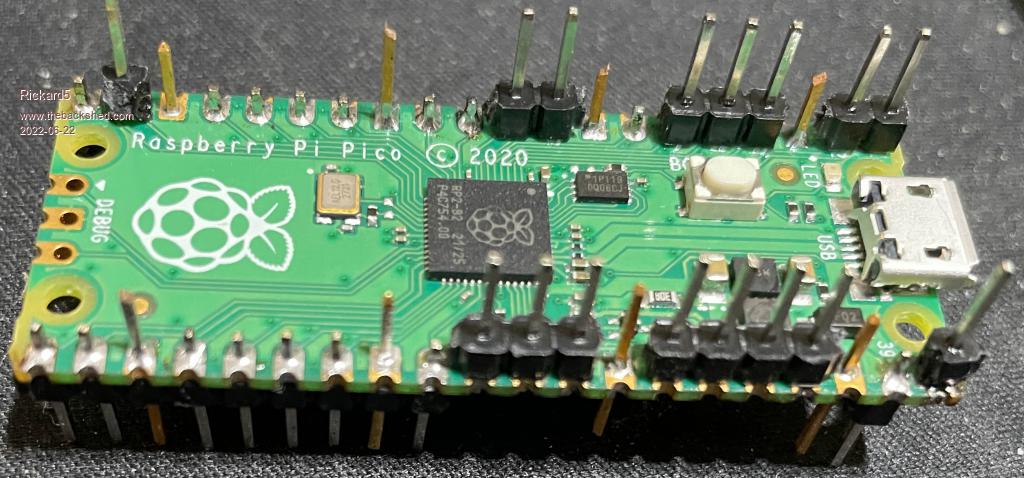

7-8 weeks ago I got one of those Waveshare Pico LCD Modules, and thought it was the neatest LCD Package for a bunch of projects I want to do, then when I realized there was no easy to Access the unused IO pins so I may be the last one to figure out to do my pico pins like this : but I got there in the end
Posts: 9329
Posted: 06:24am 22 Jun 2022
That's kinda cool...  :)
It also illustrates rather nicely just how few I/O you have left.

  Mixtel90 said  It also illustrates rather nicely just how few I/O you have left.
It does only leave 11 GPI/O pins available, but that's plenty for some meaningful Projects. I'm real interested in the idea if it's possible (and I know this may sound stupid), of offloading the I/O to another Pico and using the pico in the Waveshare as UI like almost an over simplified Cluster!

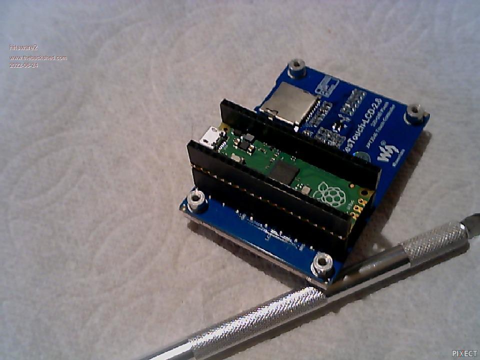

hitsware2
Joined: 03/08/2019
Posts: 738
Posted: 07:32pm 23 Jun 2022
my site

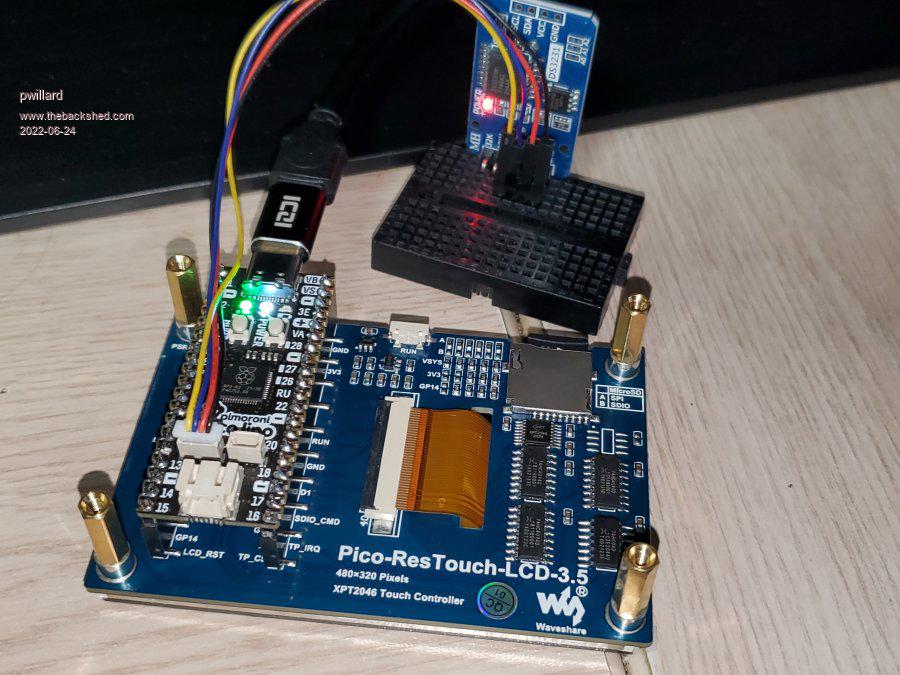

Here is how I  solve it... with a Pimoroni PicoLipo
