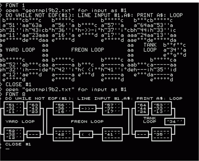

Note: code shown below is in upper case because the lower case "a"-"m" characters are shown as graphics after FONT 8.
Here's the template file from which that line drawing was produced:
b`````cb```c   b`````c        b`````c   b```cb`````c
a~51''aa~63a   a~56''a b````c a~57''a   a~64aa~53''a
bh~31''ih~43icb`h~36''i`h->>-i`h~37''i`cbh~44ih~33''ic
aa~11''aa~23aaa a~16''a e````d a~17''a aaa~24aa~13''aa
ae`````de```daa e`````d        e`````d aae```de`````da
a            aa                        aa   TANK  b``f``c
a YARD LOOP  aa       FREON LOOP       aa   LOOP  a~34''a
a            aa                        aa         e``g``d
ab`````c     aa b`````c        b`````c aa     b`````ca
aa~52''ab```caa a-----a b```c  a-----a aab```ca-----aa
eh~32''ih---ide`h~42''i`h< <i``h~41''i`deh---ih~35''id
a~12''ae```d   a-----a e```d  a-----a   e```da-----a
e`````d        e`````d        e`````d        e`````d
For instance:

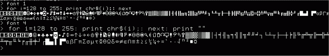

I may be misunderstanding the issue but on MMB4W the standard fonts 1 and 4 already contain the extended CMM2 character set including line drawing characters without redefining anything.

enter
FONT 4,2 then try
PRINT chr$(177)
Font 4 has the full set. the 2 is scaling the size.

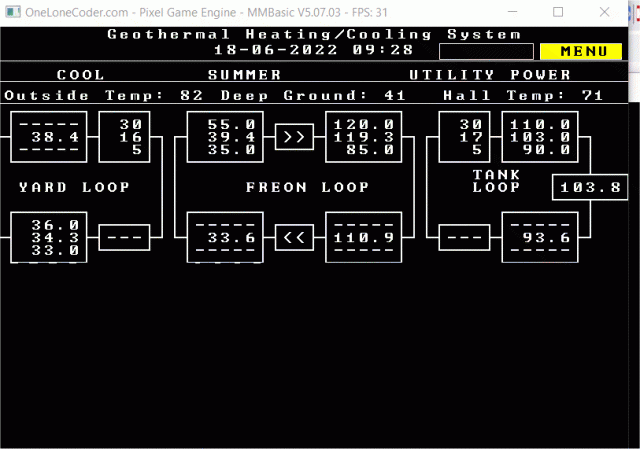

Version 5.07.03.08 is MMB4W (MMBasic for Windows), and I think the most recent version.
As Tom said back in post 5, fonts 1 and 4 have the PC drawing characters. In post 6, I showed that to be the case, printing characters 128-255, first using font 1 and then using font 4.
I also sent you the code which writes Geoff's guidemo, set for a 480x320 screen:
This illustrates the graphics capabilities of MMB4W.
