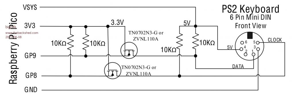

I have little (read that as none) experience with mosfets. I see the recommended circuit for the PS2 kb on PicoMite has 2 x mosfets as level translators
Actually 3 point which side is drain which side is Source on the mosfets in the example in the picoVGA manual (I told you I know nothing about mosfets)

The little mosfet circuit is very neat and is bi-directional (as is PS/2).
I've also tried a series resistor and schottky diode up to 3V3. It works, but you are getting close to the absolute max on the Pico pin. The series resistor has to be low enough to allow the Pico to pull down the TTL input (which may have an unknown pullup in the keyboard) yet high enough not to put too much current from a high TTL signal back to the Pico. It's not ideal.
I'm not sure which picture you are looking at in the manual - the current one doesn't seem to have that picture. However, the Source is towards the PicoMite site (with a pullup to 3V3) and the Drain is towards the keyboard side (with a pullup to 5V). The Gate is connected directly to 3V3. This is an N-channel mosfet.

Ok now that I know it IS bi-directional I think I MUST use the mosfet circuit.
That leaves just the question as to which pin is S(ource) and which is D(rain) in this schematic ?
I assume the top pin is the G(ate) as it looks the same in just about every mosfet diagram I see.
I think the Source is the PicoMite side and Drain the kb side but I don’t want my valuable pS2 keyboard to do a “Cheech and Chong’

The main reason it is important to get drain and source the right way around is that there is a diode between drain and source (also missing from that diagram along with the pin labels) with anode to source (Pico side) and cathode to drain (KB side). Get it wrong and you have 4.4V on the Pico pin. Fully bi-directional MOSFETS without the diode do exist but are as common as hens teeth. The diode results from the fabrication process, eliminating it requires several more expensive processing steps.
