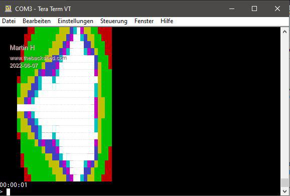

To test,how the Pico performes, compare to the old 8 Bit Computers, I translated  Matt Heffernans small Basic Program to mmbasic.
This Version uses the Terminal (VT100) for Output a Mandelbrot.
The X / y Resulution is set by DX and DY
In this case it is set to 32x22 as this is the same Resolution used in the "8 Bit Battle".
The Pico performs in Basic much faster than the 8 Bit fellows in Assembler.
(even the Commander x16 or the Spectrum Next)
'mandelbrot
'inspired by Matt Heffernan s 8-BIT BATTLE
'https://www.youtube.com/watch?v=DC5wi6iv9io
'for PicoMite is a Raspberry Pi Pico running the free MMBasic interpreter.
'and Putty or other VT100 emulation
'2022 by M. Herhaus
'clear screen, home and cursor off
Print Chr$(27);"[2J";Chr$(27);"[H";Chr$(27);"[?25l";Chr$(27);"(0";
Time$="00"
' max x and max y
DX=32:DY=22
For py=0 To DY-1
 For px=0 To DX-1
   xz=px*3.5/DX-2.5
   yz=py*2/DY-1
   x=0
   y=0
   For i=0 To 14
     If x*x+y*y>4 Then Exit For
     xt = x*x - y*y + xz
     y= 2 * x * y + yz
     x=xt
   Next i
   Print Chr$(27);"[";Str$(py+1);"H";Chr$(27);"[";Str$(px+1);"G";
   'at py+1,px+1
If i<8Then
   Print Chr$(27);"[";Str$(39+i);"m ";
 Else
   Print Chr$(27);"[";Str$(32+i);"ma";
EndIf
 Next px
Next py
'cursor on
Print Chr$(27);"[40m";Chr$(27);"[?25h";Chr$(27);"(B":Print Time$
'no comment

Hi Martin,
Pico does it in roughly 3.8 seconds (at 126MHz) tried on the VGA version.
using Putty through serial interface USB, the mandelbrot shows nicely. Although there are some "a" characters in some of the cells. Not sure if the VT100 supports 16 colors.
There is one advise I can give you:
Replace:
Time$="00" and print Time$ with
Timer=0 and print Timer.
Time$ and Date$ is the system time from the RTC (Real time clock). and when you set it to 0 , you loose your time reference. Timer is an independent variable that shows the time in ms (mili seconds). It does not change the system time Time$.

  Volhout said  Hi Martin,
Replace:
Thank you for your Response ..
the "a" is the "Checkerboard Character" on VT100, depending on the Charset the terminel uses, as VT100 has just 8 Colors,I put it in as the "light" version of the Colors ;-)
