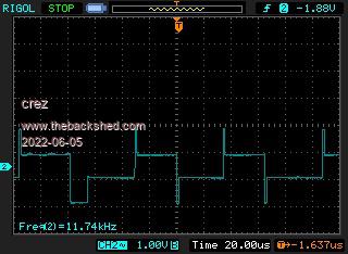

1k resistor from pin 21 to point A
2k resistor from pin 22 to point A
I expected to see pulse changing from 1/3 to 2/3 vcc.
Waveform at point A shows brief (around 1 microsecond) periods when both outputs are high and also both outputs low. Waveform also shows occasional longer periods (around 15 microseconds) when both outputs go low. It looks like the pins are updated sequentially, and occasionally an interrupt separates the two updates.

"Waveform also shows occasional longer periods (around 15 microseconds)"
Have also seen this when receiving a data stream. Rising edges sometimes recorded 5 to 15uS later than when they actually happened.
One possibility is the USB interface requiring attention occasionally.
In that instance, with a little arithmetic, just the falling edges could be used to get clean data.

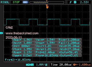

Just tried it. Have not been able to detect even 1ns difference when running the OP test program. This is marvelous !!! Can we have that please in all pico versions (also the VGA version).
Thanks a lot for making this possible. It opens a whole new area of possibilities.

Thanks Peter, I've never been referred to as the OP before .The Picomite version suits me. I will get a chance to try it on the weekend.
