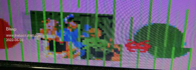

  Quote  . I do appear to be getting tearing near the bottom of the screen when I run the scroll demo,
Don't think it is tearing but there is something there. I suspect some bus conflict between the copy and reading the framebuffer - will investigate

I'm also getting intermittently the following error:-
Error : Maximum of 32 sprites
I've tried the following, I'm only loading 2 sprites, I hope!
> new
> memory
Program:
  0K ( 0%) Program (0 lines)
108K (100%) Free
RAM:
  0K ( 0%) 0 Variables
  0K ( 0%) General
140K (100%) Free
> flash load 4
> run
[4] Sprite load "invader1",2
I did also try SPRITE CLOSE ALL, the only way I've found of getting out of this is to pull the power, then it works fine again? I have not yet worked out what triggers this.
Image showing it working and the shearing at bottom of screen, as you can see, the two sprites are not being affected.
Regards, Kevin.
