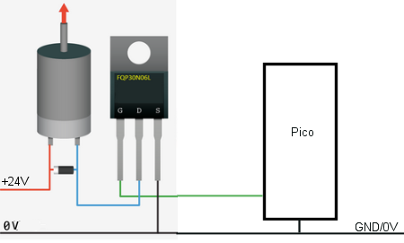

Don't be offended: It's an N type device so is best deployed in common source mode with the load between VDD and the drain - not carved in stone but for N type power driver it is my preferred hook-up and what I have used in all my designs. If you have it between VDD and the load, you might not be getting a very good Vgs and the th bit will be raised accordingly which might easily stop the thing turning on, or worse being pushed back up its trans-conductance curve where it might start dissipating. It could die very quickly in worst cases there. Illustration; if RDS could only get down to say 0.1R, at 24V that could theoretically be 240A. Unlikely your PSU would give that (batteries might) but a big spike in current would fry it, even given its a 32A device... but not at 24V (768W dissipation)
post your schematic from Pi to FET

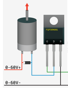

so in your circuit, you have +0-24V and -0-24V?
if the source is at -24V, the gate voltage will vary between 24V and 27.3V (relative to S). so when the pico is driving at 0V so the thing will always be on. This incidentally is a danger zone - rule of thumb, Gate voltage should be <20V
Edited 2022-06-09 01:56 by CaptainBoing

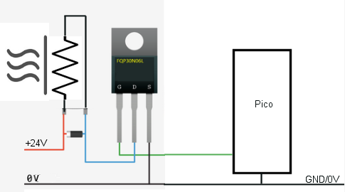

Posted: 04:05pm 08 Jun 2022
to avoid confusion, this is your circuit(?)
Edited 2022-06-09 02:12 by CaptainBoing

  CaptainBoing said  to avoid confusion, this is your circuit(?)
Exactly, except the load is resistive (heating element)
Posted: 04:19pm 08 Jun 2022
sorry I updated the picture between times.
absolutely nothing wrong with your design. precisely the same as my bed heater except I am at 27V and driving with a '170 micromite.
As mick said above, test the FET in isolation:
attach a wire to the gate and take it to 0V. Measure the voltage between D & S, it should be 24V (the FET is off)
Now connect the gate to 3V3 and measure the voltage between D & S - it should be (ideally) 0V (The FET is switched on hard... 3V3 is above VGSth of 2.5V and RDS is a few milli-ohms)
if all the above checks out, the problem has to be something with the way the Pico is driving.
connect the gate to your I/O pin and set it high then low. Do the checks again in each state. if all is OK then the problem has to be with your PWM setup.
