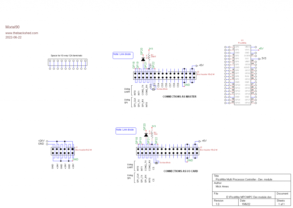

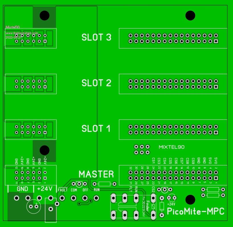

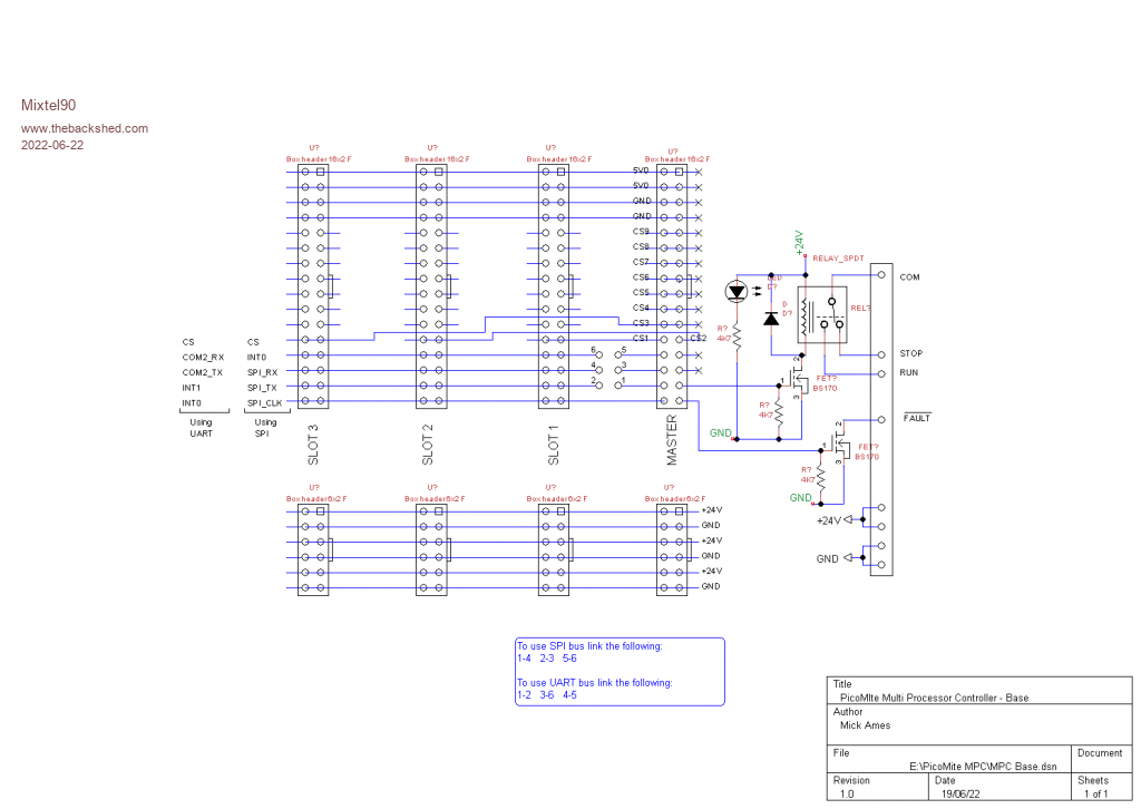

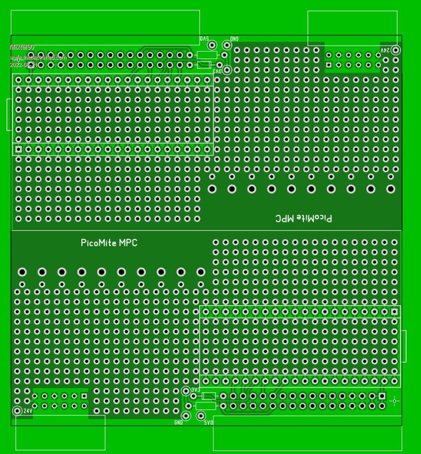

This is something else that started as a wild idea while doodling. It's a sort of design-in-progress that may or may not be attempted sometime. :)  I do these things mostly because they seem interesting. Every one is a learning exercise. lol
This is a logic controller system based entirely on standard PicoMites. A base bord holds a master controller and a number of I/O card slots (I refer to a 6-slot board as having a master + 6 I/O slots). The slots are on a SPI bus, with a CS line each. I've kept it to 9 I/O slots to give a 10-position baseboard. The base shown in the zip file is 100mm x 150mm with 6 slots, but you can get a 3-slot board in 100mm x 100mm.
Using addressable slots in this way uses a lot of pins on the master but gives fast access speed and means that there are no I/O board address switches to bother about. The SPI bus should easily be able to exceed 1MHz, with 10MHz not being unusual - I think that's quite feasible. SPI is handled very neatly in MMBasic so I think it's a good choice.

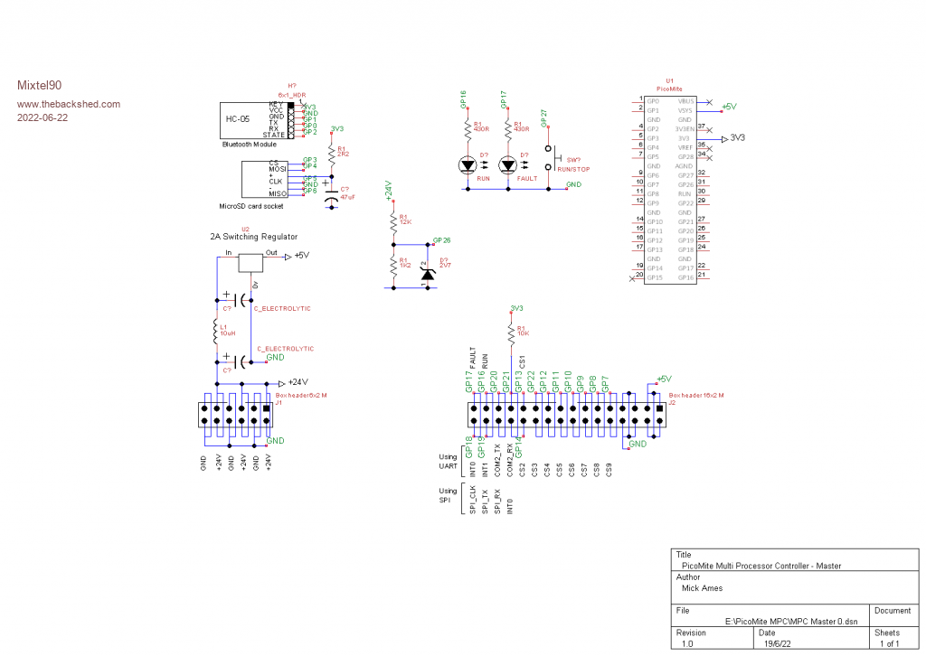

The master board also carries a buck converter (TBD) to convert the 24V board supply to 5V to feed the I/O modules from the bus. There isn't a lot of current required from 5V, and it means that you can't attempt to run the system without the master card. It has two LEDs, Fault and Run which are fed out to the base, where Fault drives a mosfet with the drain available to connect a beacon or something. The Run signal operates a small relay with a changeover contact giving Run and Off status. COM1 is fed to a connector that could be used for external monitoring or whatever. The master can also monitor the 24V supply to ensure it is within spec for modules sourcing 24V to external loads.
Each I/O board is 100mm x 50mm high and carries pluggable I/O terminals along the top. So, you can get a fully loaded 6-slot PLC into 150mm x 100mm x 50mm.
The number of I/O per board depends on complexity. At the moment I have:
5-way : Opto-isolated input, Monitored IS switch input
8-way : High-side 800mA digital out
10-way : Non-isolated low side digital out, Non-isolated digital in
A 6-slot base could, if you stick with just the 10-way boards, have 60 digital I/O. This is hardly earth shattering for the PLC world, but anything more would have needed bigger PCBs. The advantage of 100x50 is that you can get 2 out of a 100x100 "bargain price" pcb. :)
Note that nothing plugs in apart from the I/O boards into the base and the I/O terminals. This is for reliability. Also, there are no special chips used other than the Pico boards. This is important at the moment as delivery times for even simple relay drivers is silly if you want them from reputable sources. It makes the board much more complex than it needs to be, but hey - it's repairable and this is a hobbyist project anyway. :)

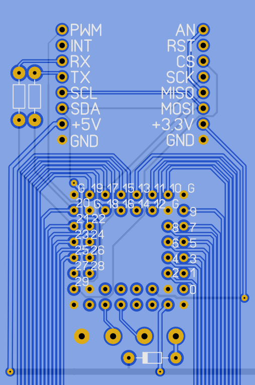

And we now have a 5-channel non-isolated analogue input card. Each channel can be independently set for 4-20mA or 0-10V. There are 5 indicator LEDs that can be used for anything - they are just PicoMite outputs. They could indicate high or low levels on each channel, or a 5-way bargraph for a single channel. I suppose I could add more...
I leave it to your imaginations how I got 5 channels. In theory it should work. :)
I often tackle a retrofit of a machine where the documentation is long-gone and somewhere along the way, I realise that I need one/both of the above due to some oddball sensor that needs to be supported...can be a real pain.
My solution to this and other possible surprises is to simply provide support for Click Modules
I have multiple channels of PGA-2040 + "Click Socket"

Posted: 06:46am 01 Jun 2022
IN------+--[ 1K ]----+------- PICO
      ___          ___
     150R         430R
      ___          ___
       |   LINK     |
       +--o  o  o---+
   4-20mA           0-10V
PicoMite has LM4040 fitted, so range is 0-3V, 3V=20mA or 10V.
Switch another 1K in parallel (or another 430R in series) and you get a 0-5V range too.
0.6V input corresponds to 4mA. Resistors should ideally be 0.1%.
Edited 2022-06-01 16:52 by Mixtel90

Posts: 9329
Posted: 09:29am 01 Jun 2022
It's not a "real" PLC, I know that. It could work in a similar way though. If each IO board runs a simple program that either copies it's inputs to a register or copies a register to it's outputs continuously then that's the basis. The master talks to each IO board in turn, reading and writing its register(s) into local ones then run through the program. Then it loops round and updates the local copies of the registers again.
Communication with the boards uses the CS line as an interrupt to pull the board out of its loop to handle the SPI. As you say, everything should be synchronous, but in fact it wouldn't be. However, the program running in the master *does* see it as synchronous as there is no interruption for IO access. The actual delay caused by the local IO register update should be very short with only 9 SPI sequences to run, all of them short.
The Siemens S5 used to use a serial interface, using shift registers in each IO module. That would have been very similar to serial SPI, program processing would stop while all the IO was read into the CPU.
One thing this system *can* do, which is also found on some real PLCs, is to allow some autonomy of the IO boards. You can run things like fast counters, PWM ramps, level alarms etc. without slowing down the main program. Obviously, these use non-standard software on the individual IO board, but it's a possibility. On all the IO boards (except non-isolated digital in) the LEDs are independent of the IO, being controlled by the PicoMite. This means that they don't have to indicate one LED per channel. That gives more flexibility, you can have flashing LEDs for alarm inputs for example.
TBH, if someone wanted a proper industrial control system then they wouldn't even consider this anyway, no matter how good it was. They usually want manufacturer support and don't mind paying for it. Not only that, but with a maximum capacity of 90 I/O (all basic digital) it simply isn't big enough for many users.
Edited 2022-06-01 19:35 by Mixtel90

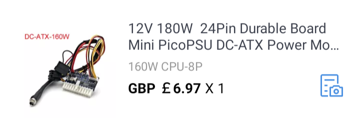

Tinine
Joined: 30/03/2016
Posts: 1646
Posted: 09:44pm 01 Jun 2022
ATX Pico (how appropriate) is my preference.
+5V
+3V3
+12V
-12V
All fused.
I have a version that takes 24V input and another that takes 12V
Craig
Edited 2022-06-02 07:47 by Tinine

Tinine
Joined: 30/03/2016
Posts: 1646
Posted: 09:12am 02 Jun 2022
You hit the nail on the head, Mick. This is the one thing that concerns me
I want clean, stable power but am clueless regarding this. I come across trivial circuitry but the supply lines can have a slew of capacitors of various sizes.
Real estate is available on my board (150mm X 400mm) so I don't mind overkill for this but I have no idea what I need to do.
Is there a general guideline out there?
Craig
P.S. I have used these things to power the E-100 with my own motion control boards and they work perfectly. BUT those were emergency/panic jobs where I paid no attention to power quality.

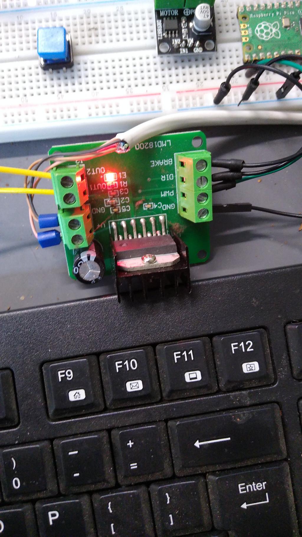

I'm messing with the seat-heater that we discussed elsewhere.
Using the Picomite PWM to drive a LMD18200. Every time I would try to change the PWM value from the terminal, the USB would be dead. Everything is hunky dory with the other PSU
