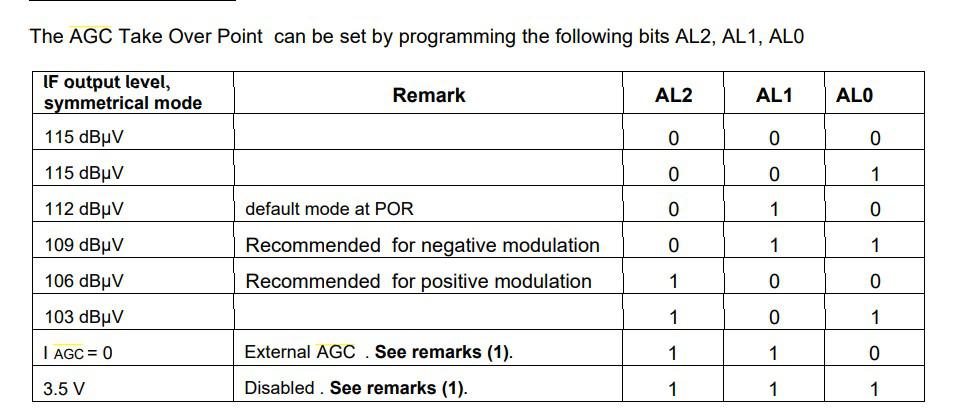

What exactly does AGC "take over point" mean?
I want to be able to switch between wanting to hear strong signals and weak signals using the I2c bus
I want to be able to switch between town strong signals due to lots of signals being recieved and I need the gain turned down
to motorway driving where I need weak signal detection and the gain turned up high
Am I right in thinking if I set the AGC pin to 115 dBµV then it will detect weaker signals better
and if I set it to 103 dBµV it would be better if the signals were stronger and I need a weaker signal gain?
Edited 2022-05-29 17:54 by lew247

The AGC seems to make sense - set it to 001 for max sensitivity and 101 for minimum.
