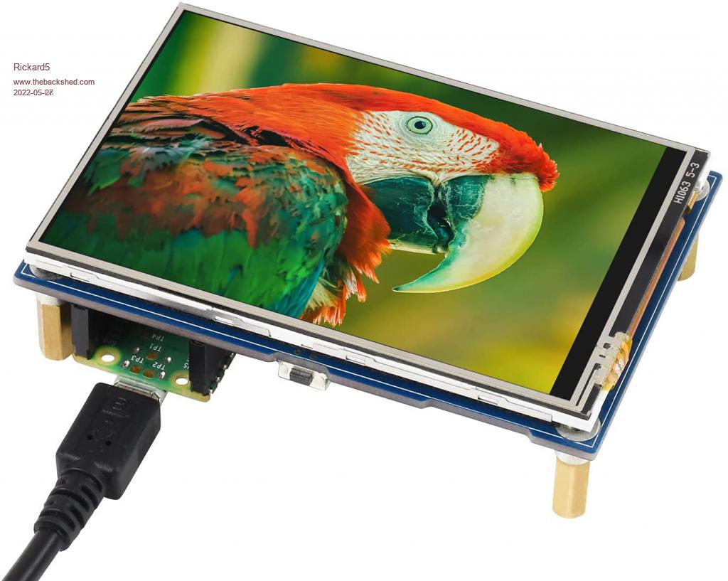

are you talking about this one with the Pico socket on the back?
OPTION SYSTEM SPI GP10,GP11,GP12
OPTION LCDPANEL ILI9488W, LANDSCAPE,GP8,GP15,GP9,GP13
OPTION TOUCH GP16,GP17
GUI CALIBRATE 0, 3946, 211, -1287, 853
OPTION SDCARD GP221

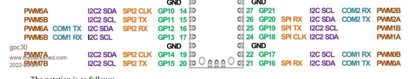

for info pinout Pico with some cards
pin_out.zip
Edited 2022-05-29 10:39 by goc30
