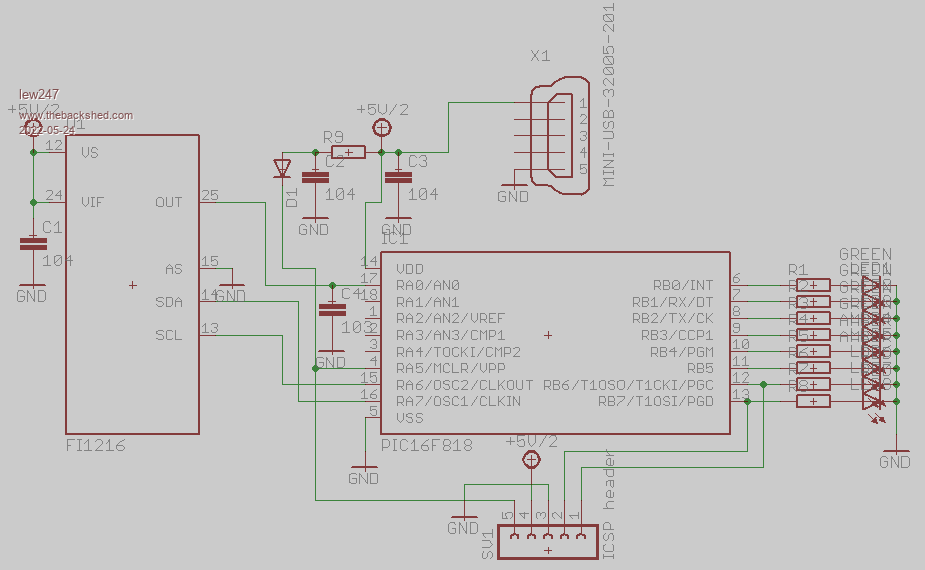

Can anyone convert this to MMBasic?
It's the code for a Tetra detector, as in the radio's used by Police, Ambulance and Fire services in Europe
The original code was written for a PIC16F818 and uses code like this which I have no clue about

One such tuner was the FI1216 which is tuned by it's I2c bus.Remove the TDA9800 demodulator and insert an AD8307 92 dB Logarithmic Amplifier and then send the output into a pic as the person who wrote the code did
but I reckon a Pi Pico running MMBasic would do it a lot better and easier

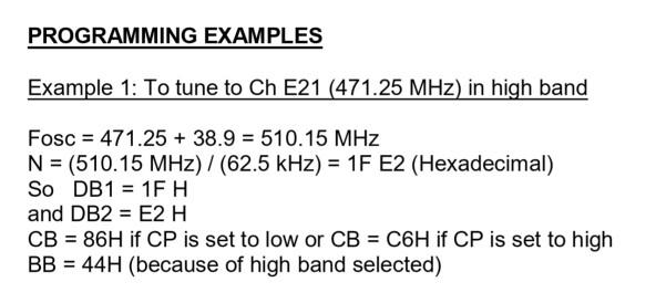

Hi Lew247,
Since you are in the UK you will have either a system B/G or system I tuner (not system L for France).
Meaning the tuner runs at 38.9MHz IF (intermediate frequency).
When you program the divider to &h1A56 to achieve 421.4MHz you use 16 steps per MHz in the PLL settings (62.5kHz step).
Since you want to tune to 380MHz, you are to use MID band (not high band since that starts at 442MHz up). Mid band is set with writing &bxxx00002 (or &h02) to BB.
The control byte (CB) must be programmed with &b10000110 to work with 62.5kHz steps, and use low current charge pump (slower tuning, but better matching 62.5kHz steps).
So CB must be set to &h86.
I hope this helps,

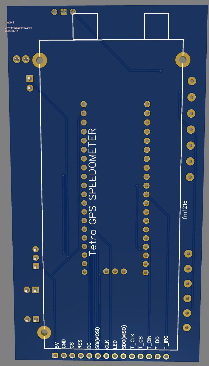

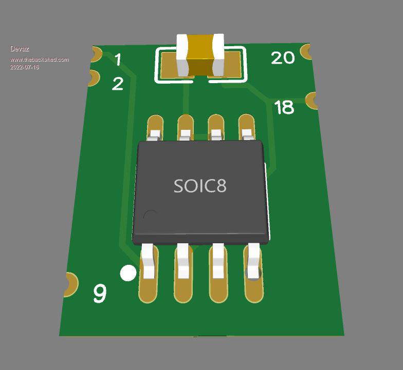

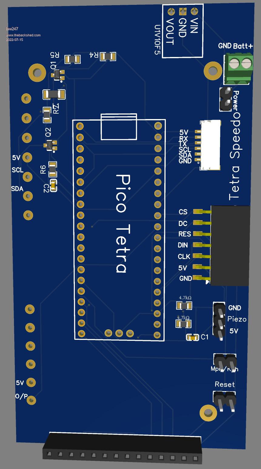

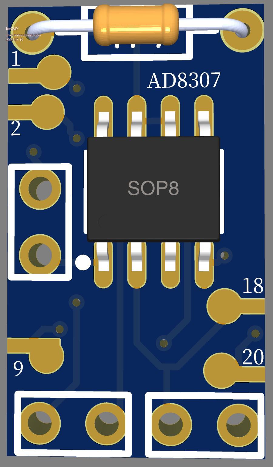

I just got the boards back from JLPCB today so once I get someone to take out the TDA9800T and solder in the board I had made, It should be relatively easy to get working
I made two boards, one for the Fi1216 that either an OLED display or one of the 2.5/3.5 displays will fit onto along with a gps/compass unit so the unit can show true speed when mounted in the car as well as tetra alerts
the 2nd board contains the replacement for the TDA9800T to convert the signal to voltage to feed to the picromite
(the board says FM1216 but should work for either)

@lew247
The PCB is nice but i think u need an extra amplifier for the signal.
