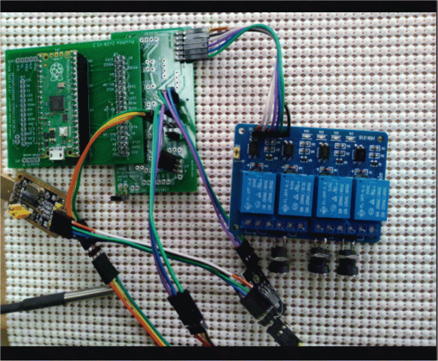

I have a picomite rigged with a 4-relay module (3 being used to turn on 12V LEDs) and two DS18B20 temperature sensors.
Here's the program which the client picomite runs:

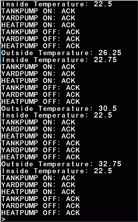

Here's the output on the MMB3W side:

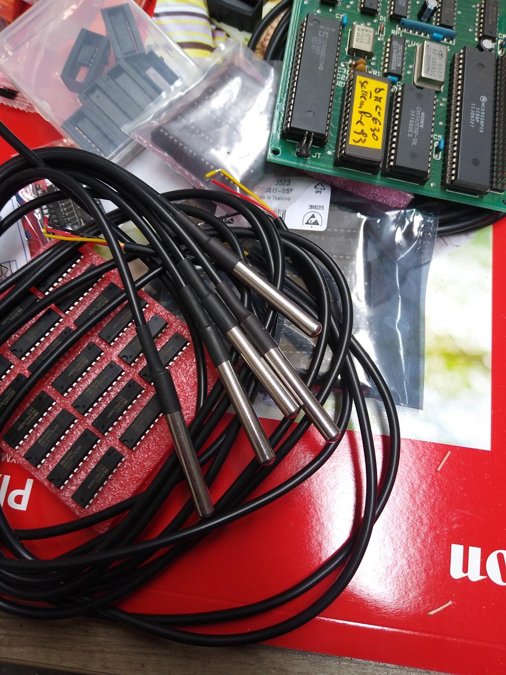

Note the "Outside Temperature" changing as I held the waterproof DS18B20.
If the command sent to the picomite sets the value of s$, then that value is returned. Otherwise, "ACK" is returned for success and "NAK" for failure of the command. Here's the output on the MMB4W side:

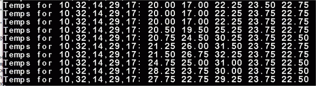

And the serial input returned to the controller:
You can see the temperatures rising and falling as I hold or release the sensors.

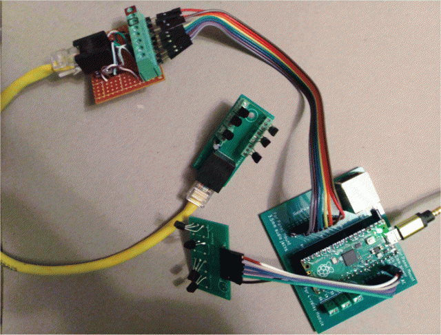

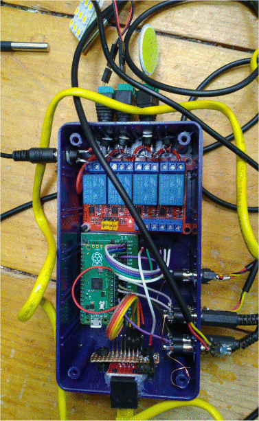

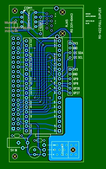

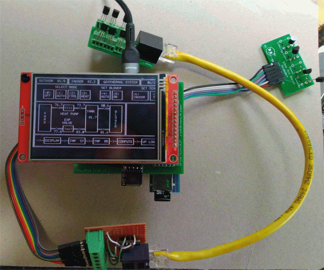

Here's another way to do this--no program at all on the PicoMite client--just MMBasic. Your MMB4W program just acts like a user by supplying commands at the ">" prompt, and interpreting the result.
I set up serial console and connected through 10' of Cat5 with a couple of RJ45 breakout connectors. I used Mixtel90's picomite with 20x2 header, cut out of his "pear" pcb:
This picomite is in a box with a 4-relay module. In addition to the RJ45 connector, the box has 4 power panel mount jack for the relays plus another for the voltage switched by the relays, and 5 panel mount 3.5mm stereo audio jacks for DS18B20 sensors.
I don't have any notable skill as a machinist, even in plastic, but it does work:
The program defines the four pins controlling the relays and sends a SETPIN command for it. Then in an infinite loop it sends a command to randomly turn on or off one of the 4 relays, and to print the 5 temperatures ("? TEMPR(pin#)") separated by a space each. With FIELD$, the program breaks out the temperatures, formats them with 3 decimal points, prints them, and then pauses for 2 seconds.

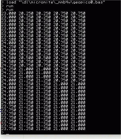

Here's the output; you can see the temperatures change as I touch and release the waterproof sensors:

  lizby said  I set up serial console and connected through 10' of Cat5 with a couple of RJ45 breakout connectors. I used Mixtel90's picomite with 20x2 header, cut out of his "pear" pcb:

  lizby said  I don't have any notable skill as a machinist, even in plastic, but it does work:

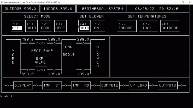

The intention is to use a Windows/LINUX box with a screen and rudimentary keyboard running MMB under either DOS or Windows to control a PICO or CMM2 (if it is ever available again) to control the machinery. I'm confident in the stability of MMBasic. I'm not terribly worried about power failures because the machinery will be shut down without power anyway. I am concerned about the whole thing being able to start up and resume operation after a power failure.
I suspect that I will default to the DOS extended ASCII box characters for the display screen.

In your photograph of the blue box I don't see a row of jacks which would connect to each of the temperature sensors. It looks like there are insufficient jacks of all types to make the box truly pluggable. Where did you hide them?

In the photo there are 5 3.5mm 3-connector jacks on the lower right, with holes drilled for 9 (3 columns of 3 jacks). I've since added 2 more for a total of 7 (9 available).

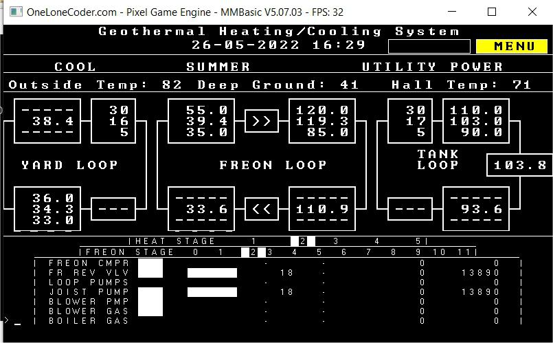

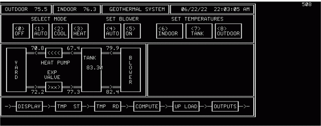

Here's the latest iteration, using Paul_L's PC graphics character display and running on MMBasic for Windows while reading 10 DS18B20 sensors on a Picomite which has no user code--just the MMBasic firmware:
(The "508" in the upper right corner indicates that the program has completed 508 main loops.)
This is essentially throttled by the time it takes to complete a TEMPR START on the Picomite (around 800ms with a resolution of 1/16 degree C), so the MMB4W code only calls on the picomite when the seconds of a time$ call changes. In practice, the temperatures update every second (all 10 sensors), but about once every 8 seconds the time (HH:MM:SS) shown on the second line of the display skips a second.
This is the hardware for test purposes. When I put a finger on a DS18B20, the changes in temperature are reflected in about a second.
I note that there's a spurious zero in the tank center reading. I suspect that's because of a reading of 1000 at some point. I will be checking for readings of 1000 (generally "not connected", but can be spurious) or 85 (probably missing pullup) and logging them.
