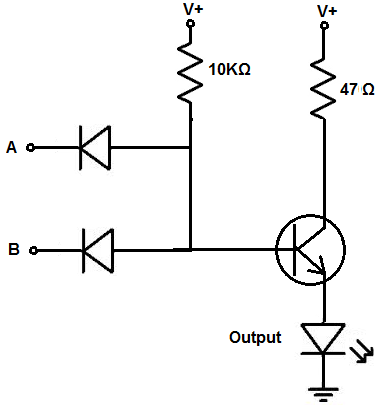

The BITBANG BITSTREAM command would be one way to send any bit sequence. Use a diode / resistor AND gate to mix that with a 38kHz PWM square wave from another pin.
To get the original bit sequence you could possibly use Peters CSUB LOG to capture the output of the IR receiver. Or find the transmission protocol on the net and create your sequence from that.
You could eliminate the need for the AND gate by replacing the bit pulses in the bitstream with the required number of 13uS pulses and 13uS pauses to produce the complete 38kHz modulated signal on one pin.
