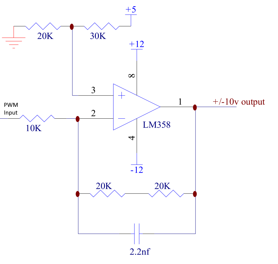

Question for the analogue/analog experts:
The following has served me well on a 5V system. Will I need to change component values for the same to work on 3.3V?
Don't have all of the components with me so can't test.

Thinking: Switch the 10K to 6.6K and limit the PWM to keep within +/- 10V.

I just experimented on Circuit Simulator. First experiments indicate changing the lower half of the potential divider from 20k to 6k8, feeding it from 3V3 instead of 5V.
Not had time to go further.

  Mixtel90 said  I just experimented on Circuit Simulator. First experiments indicate changing the lower half of the potential divider from 20k to 6k8, feeding it from 3V3 instead of 5V.
Oh Cool...Thanks again buddy
Just out of curiosity, what do you get if you switch the two series 20K resistors for a 33K and a 27K?

Posted: 05:20pm 11 May 2022
You go from 40k to 60k, so you get +/-15v out. Which will not be possible when powered from 12v
Better use 18k and 22k
Edited 2022-05-12 03:22 by Volhout
Posts: 9329
Posted: 06:24pm 11 May 2022
Circuit Simulator isn't truly realistic (it's an ideal op-amp and a roughly simulated capacitor), but it's showing that the output is +12 down to -10 for duty cycles of 0.1% to 99.9%. That's approximately the same as the original circuit showed IIRC. I went for a freequency of 1kHz, but that only affects the quality of the output for a given capacitor.

Posted: 02:21am 12 May 2022
G'Day Craig
If you change the 30k to 26.15k (file the end off a 27k) that will give a voltage of 1.43 at +ve input and -ve input.
Then change the 20k + 20k to 60k (27k + 33k) it should give you what you want.
Good luck
Peter
And change 5V to 3.3V.
Edited 2022-05-12 12:50 by PeterB

  PeterB said  G'Day Craig
You kiddin' me? I'm talking precision, here....I'll stick it on the surface grinder
Many thanks, Pete
Good luck
Peter
Hmmm, I wonder....
If I stick a 50K trimpot (only because I have one) in there and fiddle around in the 26K area, would this effectively provide an offset trim?
Not really critical in this application but it's just nice to have a zero-volt output from a 50% duty cycle.
Can't get to my breadboard stuff until the weekend.
Craig
PeterB
Joined: 05/02/2015
Posts: 669
Posted: 05:16am 12 May 2022
The important parts are 1.43V on +ve input and 60k for the gain. If these are wrong you will get a wrong answer. Would you like me to calculate what would result from just the 26k adjustment?
Peter
Ein = 3.3V Eout = -6V
Ein = 0V   Eout = 7.15V
That all assumes I remember Ohm's Law.
Edited 2022-05-12 15:25 by PeterB

Seriously, what sort of precision are you after? Are you wanting to convert 3.3 volts PWM signal to */- 10 volts?
Assuming 3.3 volts:
Set the + side of the op amp at 1/2 that with a resistor divider. Easy to do with two equal values of resistors in series across the 3.3 volt supply.
Not sure what the range of (filtered) output voltage you will get from the PWM - say: 0.3 to 3.0 volts. That is +/- 1.35 volts swing either side of the middle of 3.3 volts (1.65 volts)
You now want the op amp gain to be 10/1.35 or 7.4. Choose the input resistor that you want, say the 10k in your circuit and make the feedback resistor 7.4 times that value.
Try 75k for a start.
PS use a trim pot instead of a file to adjust the value if you need to.

To correct 27K to 26.15 no need for a surface grinder or file just stick a 820k in parallel.
Bill.
I'm not sure your idea will work.
Peter

To get that accuracy don't forget the pico pin impedance is in series with the 10k. It's about 40 - 50R, so the resistor will need a little elasticity! (1M trim-pot instead of 820k perhaps?)
A 1k trim-pot in the middle of the voltage divider will let you set 0.0V at 50%.

  phil99 said  To get that accuracy don't forget the pico pin impedance is in series with the 10k. It's about 40 - 50R, so the resistor will need a little elasticity! (1M trim-pot instead of 820k perhaps?)
The PWM is actually from the Propeller P2; 14bit @10KHZ
Yeah, from my know-nothing-about-opamps view, the original circuit has a gain of 4 and with a max input of 5V, 4 * 5V = 20V (range)
60K of feedback = a gain of 6 and so 6 * 3.3 = near-enough.

Posted: 06:33am 12 May 2022
Bill.
I think your idea fails because with 1.65V on the +ve input, there must also be 1.65V on the -ve input.
So then the voltage across the 10k is Ein - 1.65 and for Ein = 1.65, Eout must be 1.65 since no current can flow.
There was a time when I was quite good at this but today I have used up my supply of scrap paper just trying to work out how to work it out.
I had to remember simultaneous equations ????????
And don't forget we are going to have a glass of red one day.
Peter

Posted: 06:43am 12 May 2022
Hi Peter,
You're correct of course. 1.65 volts is the new zero so the swing will be about that. I also used to be good at this but I've killed too many brain cells.
Things have conspired against me so far but I haven't forgotten.
