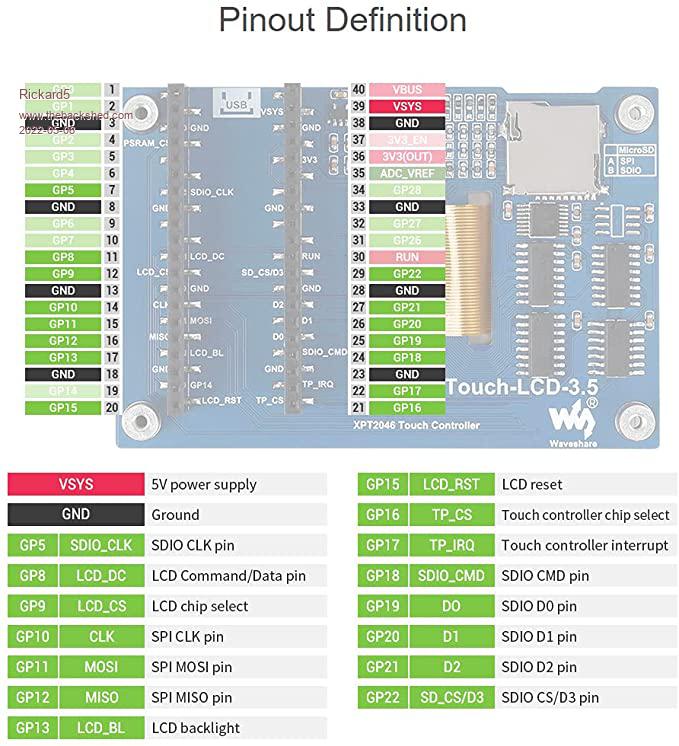

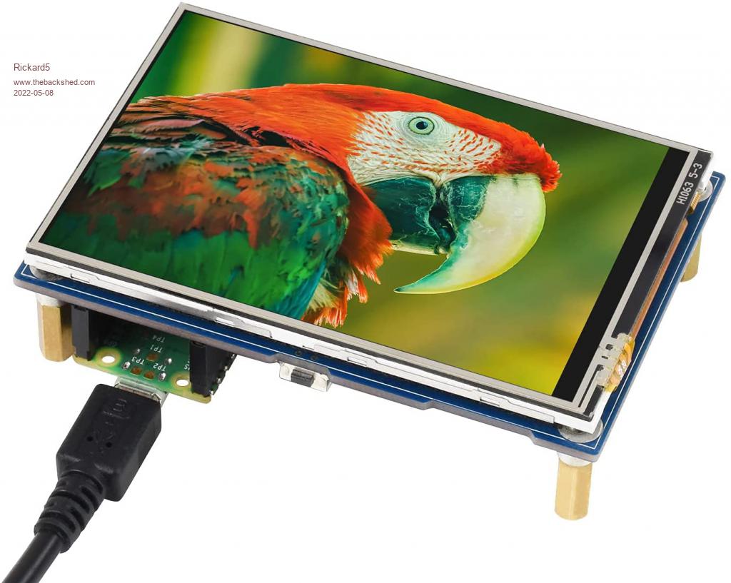

So Last night I sold my soul. I may be going to the fiery place below, went to that book store Captain Kirk  runs like a Chinese Labor Camp, and was looking for an ILI19488 LCD for a PM Project I have in my mind when Low and Behold I found  This  Please tell me this will work I drunk bought 2  of them
Amnesie
Joined: 30/06/2020
Posts: 763
Posted: 11:08pm 07 May 2022
See manual page 43.

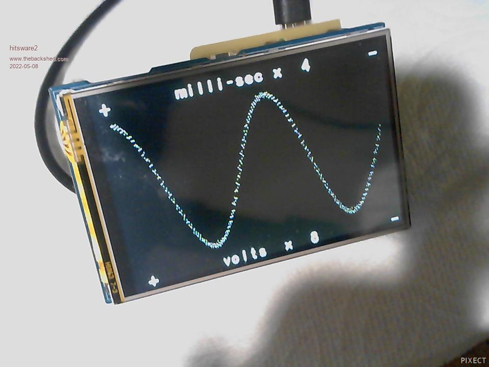

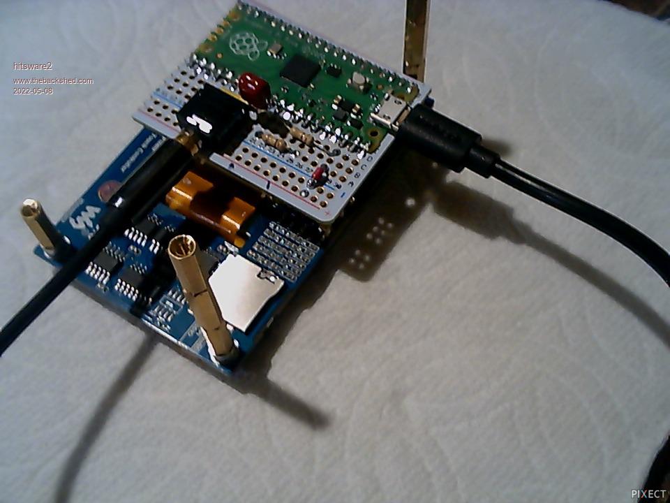

Those work great ! So much easier than trying to sort
through the SPI wires
