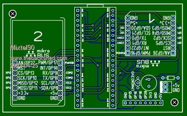

Posts: 9329
Posted: 11:44am 25 Apr 2022
Something like this?
  Quote  I have this other thing coming your way and thus far it has 4 Picomites, a Prop-2 and 156 I/O
That's just cruel....   :(
Edited 2022-04-25 21:48 by Mixtel90

Posts: 1646
Posted: 12:43pm 25 Apr 2022
Oops!

Posts: 9329
Posted: 01:08pm 25 Apr 2022
No prob - nice to see a proper one. :)
I hadn't realised that SPI and I2C could be shared or that RST was individual to the module. I didn't bother with level shifting either - it's 3V3 or don't bother.
I'll not chase it further.
