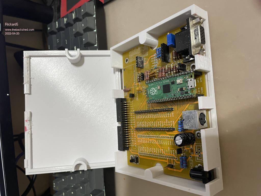

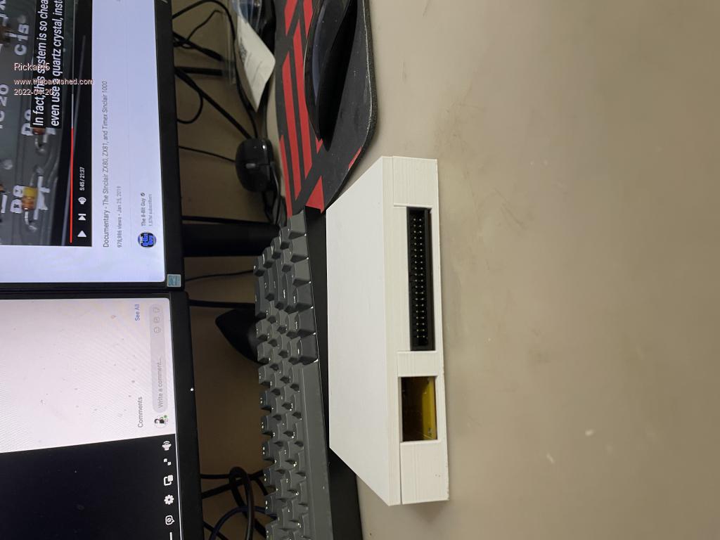

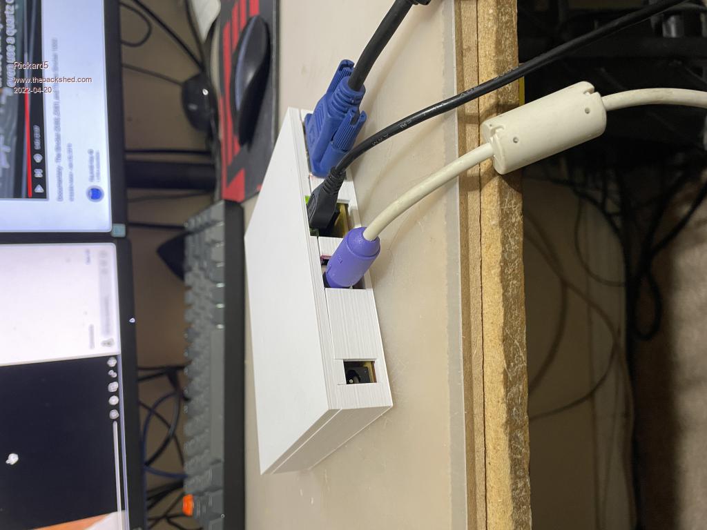

Beta 1 of My 36 Cent Picomite VGA case:
there is some refinements to make in a second beta the lis is a Friction/ snap fit so there is no hardware, the lis wraps around side posts to hold down PCB when I get a final version I'll post up a .STL File :)

Looks good. The back opening for the MicroSD card is a bit large - the Adafruit module is wider than a MicroSD card.
Also you’ll need to decide where to put the 3.5 mm stereo audio jack. I soldered the jack to a small piece of perf board and placed it in the back right corner next to the MicroSD card.

Thanks Al That is just a Beta, I've Grown to HATE the Design Language of the Square candy box but this Beta version accomplishes 2 great things, it gives me a place for my PM VGA to land for now and gives me more accurate dimensional Data for for the 6 iterations too come. The SD Card opening is just a Place holder until I get my SD Card reader to get here to measure.  I do plan to place a 3.5 jack to the left of the SD Card and a Cmoy amp in the case with 2 (l&R) headphone Drivers I have some left over Grado Labs drivers I want to put in the case. I'm looking for a common Design Language I can live with as my Goals Change. I know I am a Newbie and have no right to express this but I'm finding myself looking for a PBC Cad/Auto-router to learn, because my Hardware Design Desires has deviated from the established more knowledgeable members of the community. I'm going to have to design  Language that is Honest to the Community hardware designs as well as any goals I have outside of the community fork!
