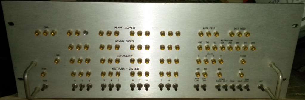

Around August 1974, Electronics Australia started a monthly series on the design and construction of a simple microcomputer called the EDUC-8. It was conceived and designed from the ground up by then then Editor, Jim Rowe.
Loosely based on the instruction set of the DEC PDP-8, it was one of the first hobby microcomputers. Built entirely from 74xx series of TTL chips, it was a fully functioning microcomputer. My brother and I built one and last I heard from him, it is still operational.
In an attempt to re-live some of those days, I have created a "glass" version of EDUC-8 - that is, a simulator written in MMB4W (it should also run on a CMM2 but untested at this time).
For anyone interested, a copy of the code is included below. It is still a work-in-progress as I have not implemented any of the IOT instructions. If anyone wants to get more deeply into the program, you will need to obtain a copy of the full manual "EDUC-8 An Educational Microcomputer" by Jamison Rowe. It may no longer be in print but I could perhaps copy parts if anyone is interested (I will try to contact Jim Rowe or EA/Silicon Chip to determine the status of the book).
To actually get something out of the program, the following is a taster!
Start by installing the latest MMB4W and run.
you should see the MMBasic sign-on prompt.
Enter the following at the prompt:-
>OPTION KEYBOARD US
>OPTION DEFAULT FONT 2
>OPTION DEFAULT PATH "C:\Users\yourloginname\Desktop"
>OPTION LIST
... should now give you ...
OPTION Default mode 9,1024x768
OPTION Default Font 2,1
OPTION Default path C:\Users\yourusername\Desktop
OPTION Keyboard US
Current display 38,85
.. so now
>load "educ-8-5a.bas"
>run
.. and you should see an Educ-8 front panel with all switches off - start by entering an initial load address using the mouse to operate the relavent switches.-
000 LOAD
enter the following in the switches, clicking DEPOSIT after each new instruction
(see page 47 of EDUC-8 book)
710  DEPOSIT
110  DEPOSIT
111 DEPOSIT
312 DEPOSIT
500 DEPOSIT
721 DEPOSIT
.. now for the data
010  LOAD
002 DEPOSIT
004 DEPOSIT
000 LOAD
.. clicking EXAMINE will step through the memory
.. clicking RUN will step through the program, which is
START:    CLA              710  ' clear accumulator
         TAD A            110  ' two's comp add loc &O010 to AC
         TAD B            111  ' two's comp add loc &O011 to AC
         DCA C            312  ' store result in &O012 and clear AC
         JMP START        500  ' jump back to loc &O000
         HLT              721  ' halt
A:           002
B:           004
C:           should end up with 006 in here
To exit the program, any keyboard key will drop you back to the MMB4W prompt. If the program is running and you click outside the MMB4W widow and then try to return to the running program it will crash unless you click on the MMB4W header first (I use the GUI AREA command for switches hence the out of bounds error).
Single/Continuous and Slo/Fst work however none of the IOT instructions have been implemented yet.
Enjoy,
Doug.
