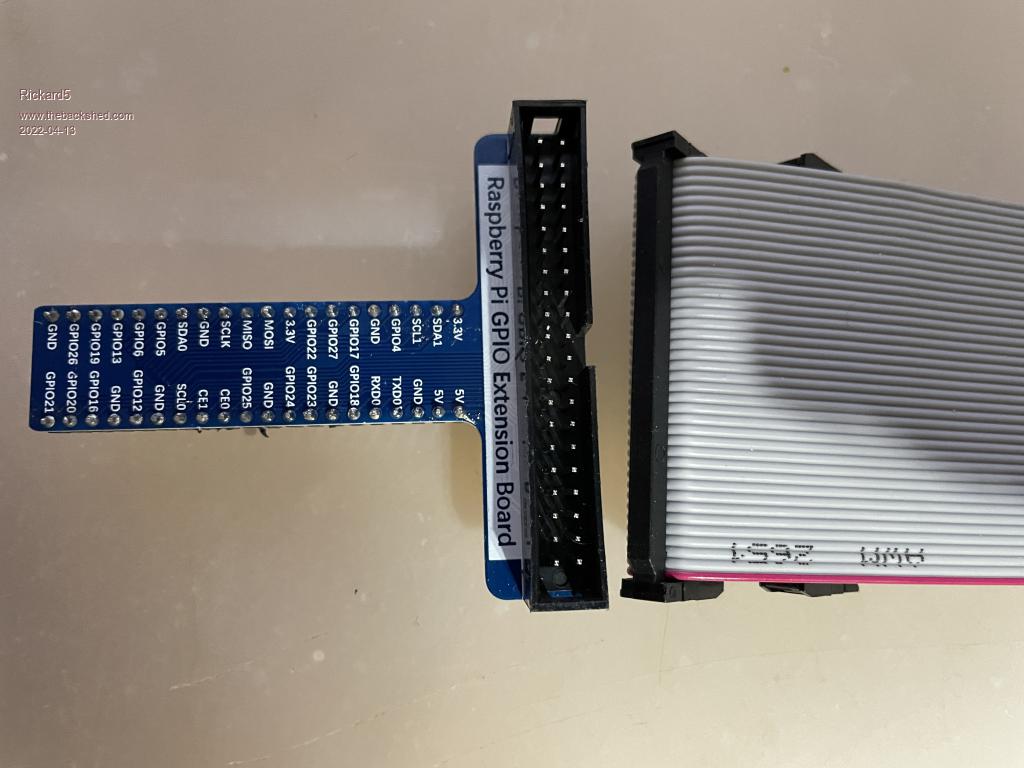

I've got a couple of these Raspberry Pi GPIO Breadboard Breakout boards around, and it would be neat to use them with the 2x20 port on the PM VGA. Has anyone rang them out? Is there a Chart or diagram to show the pin out of one of these  Pi T-Cobblers with?

This is hardware so my standard line is "I know nothing", but the cobbler I've got has all the GND pins tied together and I don't believe these match up with the GND pins on the PicoMite 2x20 port - though I actually can't recall seeing a diagram of the latter yet.

Mick I'm trying to use this with a Picomite VGA 1.3 board, When my dear Precious CMM2 gets here no way am I touching any expansion port on such a rare beast that plays Gauntlet and hopefully soon Wolf3D and Doom :) With the pico worst things I can do is blow up a $2 Pico and I got 50 of them and next time Microcenter has them I'll buy all they'll let me with the rainchecks I accumulated while they were on sale :)

CMM2 G2 has the pinout orientation to suit the RPi breakout correct.
On the CMM2 G1 the standard layout has the pin orientation reversed and requires a simple mod to either the breakout cable or the CMM2 shroud.
If you have anything other than the official board design, you will need to check.
With the pico board, as long as pin1 ends up towards the led and SDcard, all should be well.

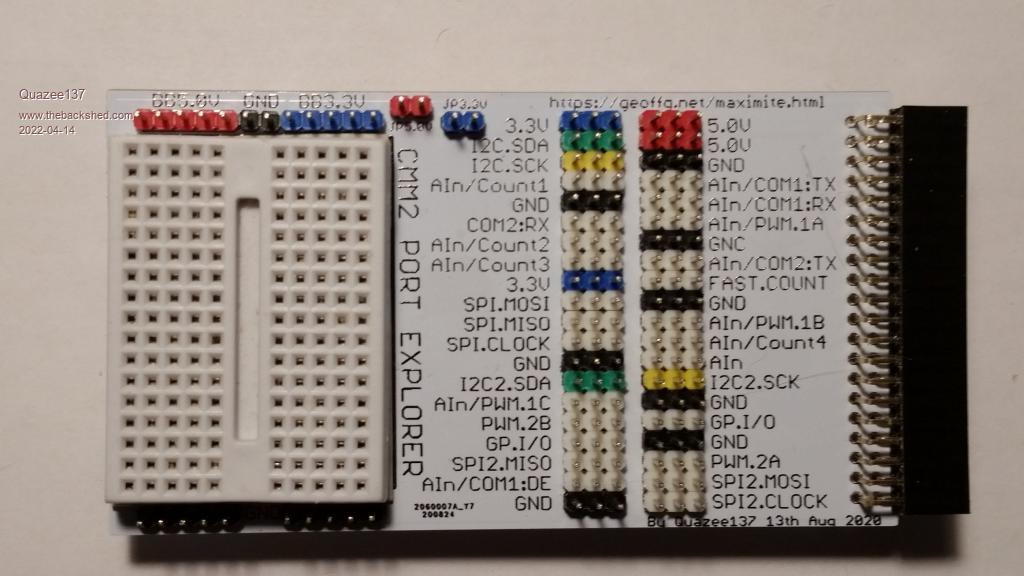

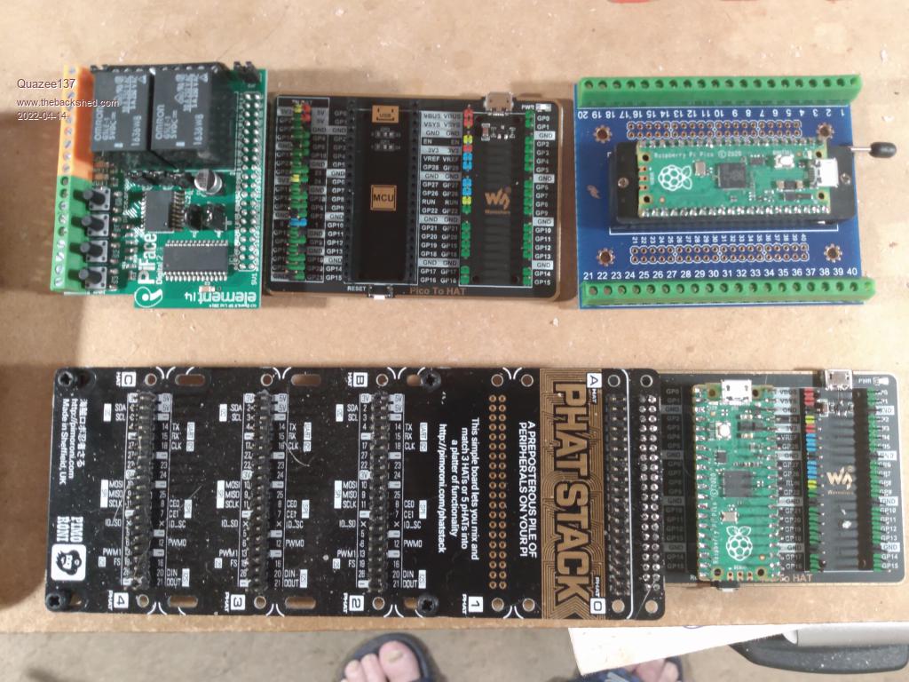

Here is what I have been playing with.
Waveshare Pico To Hat, PiFace, MDFLY Breakout Board, PHAT STACK and
my CMM2 Port Explorer.
I have the RPi 3.2" and 4" Displays coming back from MM170 units out in the field.
working on changing all my MM170 designs to Pico.
Having FUN

Quazee137
Joined: 07/08/2016
Posts: 603
Posted: 05:27pm 14 Apr 2022
Volhot here is the post from back then.
Port Explorer
 I have more boards the kits sold out.
PM me your mailing info and I'll send one.
