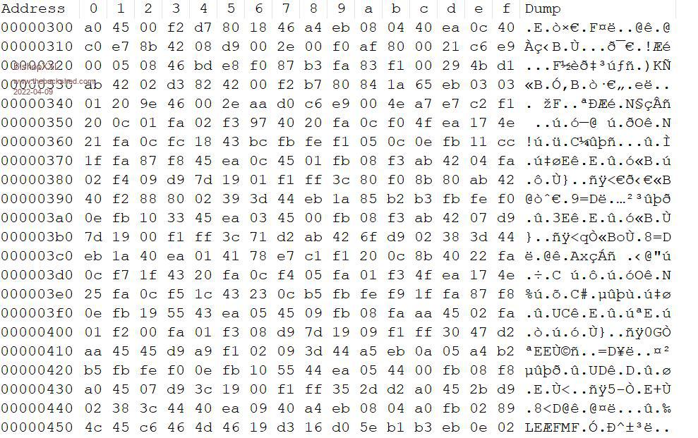

Posted: 10:57am 09 Apr 2022
Hi Tom,
this is a snippet of the dates that would come, yes 00 and 03 too
