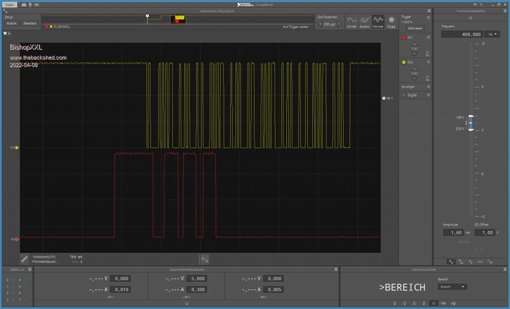

Hi all,
Is there a txd register in the pico(mite) / I'm sure there is! which I can read in basic so I know when the byte left the buffer.
BTW, this is about switching from RE/DE to RS485 communication.
Thx @ all
BishopXXL
SetPin GP1, GP0, Com1
SetPin GP2, Dout
Open "Com1:115200,1024" As #8
Pin(gp2) = 0
For i = 65 To 68
  Pin(gp2) = 1      ' RED
  Print #8, Chr$(i) ' YELLOW
  Pin(gp2) = 0      ' RED
Next i

Check the LOF function

Its not quite perfect as it will only show when the last character has been moved from the buffer into the UART shift register so depending on application you may then need to wait for the bits to clock out which can be calculated from the baudrate

Hi matherp,
yes thanks for the tip, that's what I thought when I saw it.
