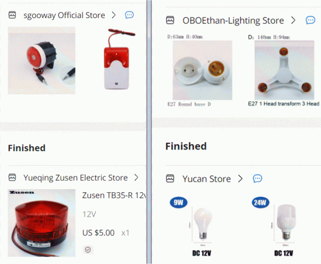

Posted: 02:11pm 02 Apr 2022
  Amnesie said  IWhat are you using it for? What does it switch?
Nothing big: switching 12V for this and this and 12V 15W LED Bulb E27 Lamps, E27 3-bulb & 1-bulb fixtures.

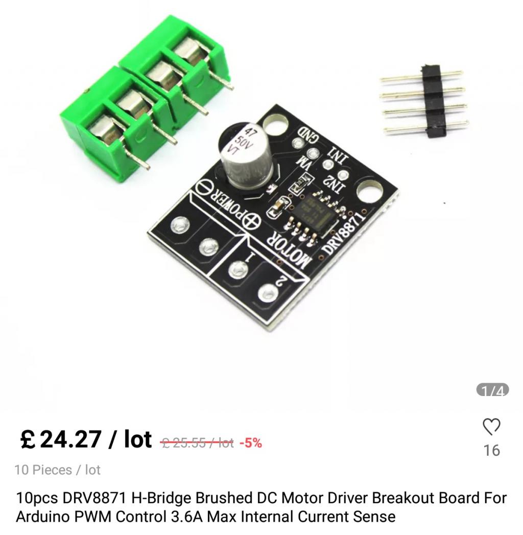

Posted: 04:18pm 02 Apr 2022
Price has increased on these things. I got 10 for <16 quid:
Craig
