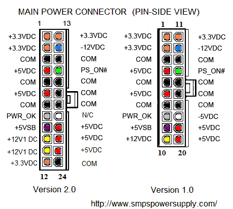

I just happen to be looking at ATX power supplies because I have used the ATX-Pico type with my mites. They provide everything that I need; 3.3v, 5v, +12v, -12v.
A couple of the pins...I'm not absolutely sure what they do but it might be worth checking before going-off on a tangent.

The extra four pins on the V2 connector are often on a 2x2 connector that fits on the end of the 20-pin one.

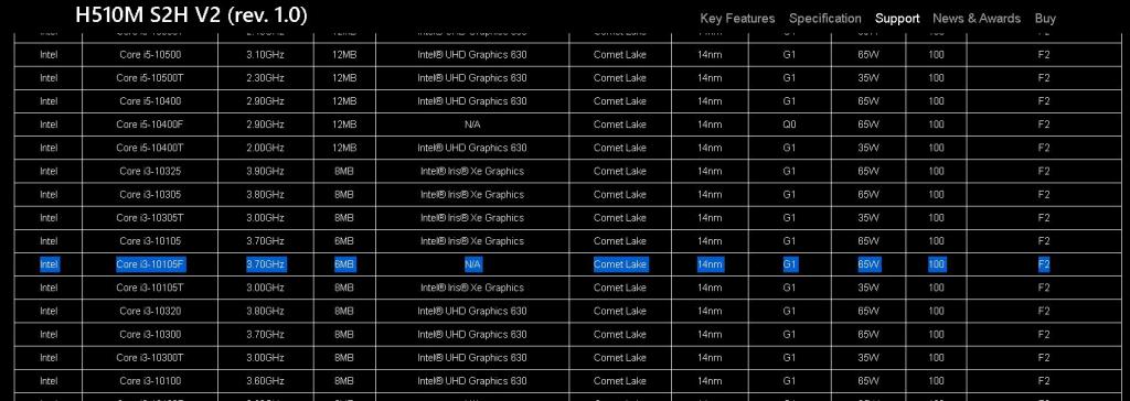

I looked up the Gigabyte supported CPU list here.
The CPU they are using is an Intel "i3-10105F, 3.7GHz, 6MB Cache, LGA1200"
According to the list, this CPU is not supported without an add-on graphics card?
The "N/A" in the graphics column is defined at the top of the list as "Not support", so I think I need to add a graphics card before the board will start, as this processor appears to JUST be a processor and has no integrated GPU so the video sub-system cannot be started, therefore....CPU error.
Failing that, I think I need to get a CPU that HAS an integrated GPU, and that will probably solve the problem I think.  I expect they got the i3 they have, as it was the cheapest i3 they could find new, but that might have caught them out there!

Grogster, I think you nailed it. I googled that chip and found:
Does Intel Core i3 10105F have graphics?
This processor does not have integrated graphics, you will need a separate graphics card.
Edited 2022-04-02 10:50 by al18
