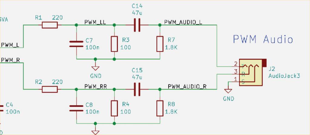

  Quote  https://geoffg.net/Images/Maximite/SchematicLarge.png
The caps create a low pass filter, they do not decouple the output. The other resistors form part of the filter and also a voltage divider. Component values are not critical. My board copies:
Here is the recommended circuit from the RP2040 H/W manual
Posts: 9329
Posted: 08:52am 29 Mar 2022
That's a good circuit in that it takes any DC bias off the output using C14 & C15 (+ end towards R3 and R4 if polarity conscious) and makes sure the caps are discharged using R7 & R8 so there is less of a switch-on pop. Output is set by the ratio of the first two resistors - about 1V.
