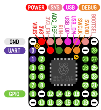

Posted: 10:46am 28 Mar 2022
Pico on a stamp

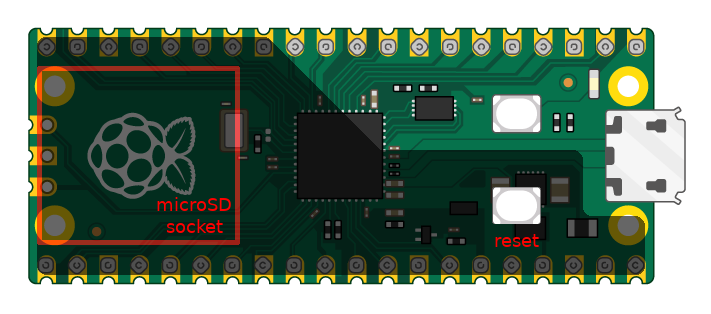

I like those small boards, but (in my opinion) the ideal MMBasic RP2040 board would at least support an SD card.
Many applications I see for it would like to store data, or use "include" files, or support files, in the basic program (*). The current MMBasic RP2040 flash storage (7 program slots) is not really suited for that. So you need to add an SD card.
(*) According Peter it is not feasible to use the flash storage that is currently used by the 7 slots for a file system (like the CMM1, that has a drive A using internal flash, and the SD card is drive B). I remember it was becuasse the flash would wear out too fast.
Too bad, for CMM1 the SD card is optional, you don't really need it. The A drive is small (few 100k) but can be used for individual files.
Posts: 12185
Posted: 08:30am 31 Mar 2022
  Quote  According Peter it is not feasible to use the flash storage that is currently used by the 7 slots for a file system (like the CMM1, that has a drive A using internal flash, and the SD card is drive B).
The main reason is actually that I'm not prepared to code it. To use the flash in this way you would need a filesystem for the flash with built in wear levelling such as LittleFS (as per ArmmiteL4). Then every single file handling mechanism in the code has to be generalised to handle both (incompatible) filesystems. This is a huge bit of work for marginal benefit to most users. As always if anyone wants to code it then the source is available.
