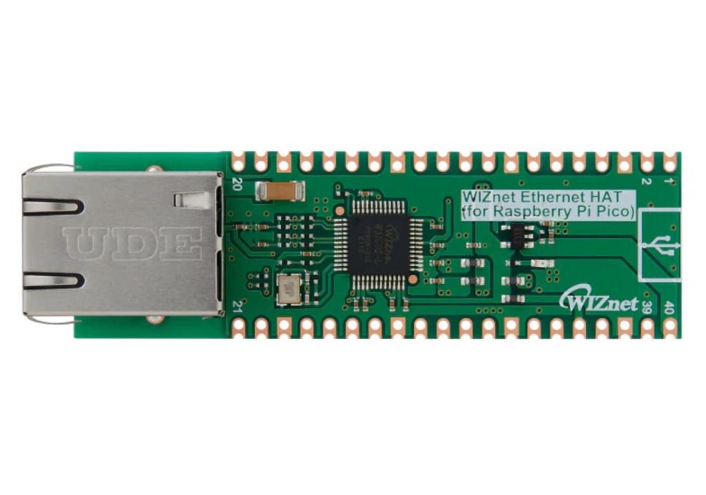

Has anyone developed any code for the Pico or any MM device to use Ethernet via cable?
Im thinking about something like an LAN8720 breakout board
or this as its only around GBP5
It has C/C++ Examples here and
CircuitPython Examples here
Has anyone done anything similar and has examples of how to code with MMbasic with them?

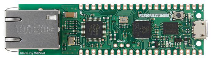

Interestingly, I note that WIZnet actually make and sell a PICO module, with the ethernet combined on the one unit - clever, and only US$10.
Link...
Edited 2022-03-14 10:25 by Grogster
