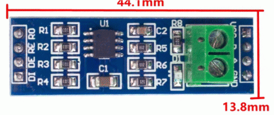

I have an RS485 module from aliexpress, https://www.aliexpress.com/item/1005003204223371.html, but I don't understand how it is supposed to be connected. The screw terminals are connected to A and B, but at the other end of the device, what are DI, DE, RE, and RO?

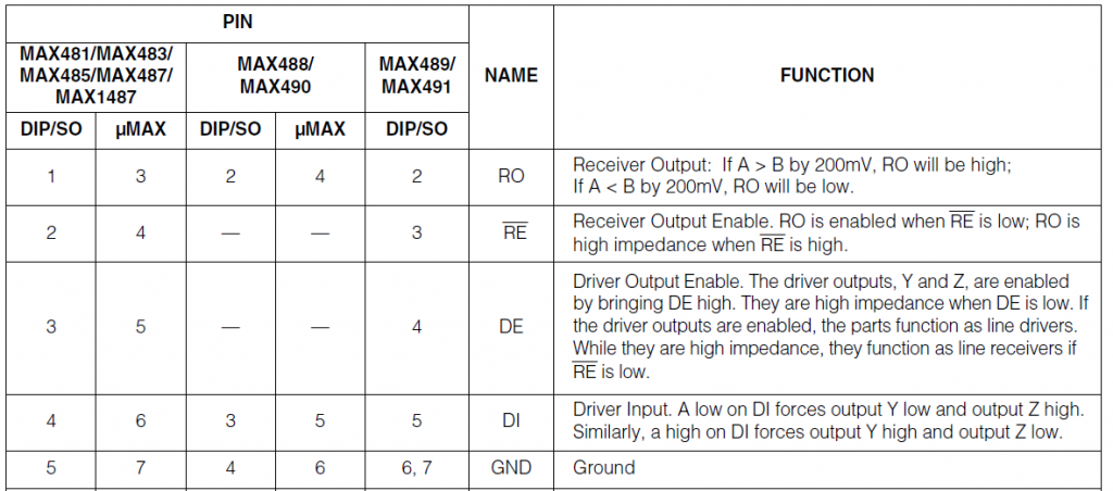

The MAX485 data sheet gives you a clue.

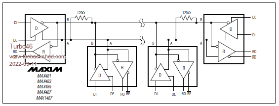

Yes. You have the right module see Mick's circuit .
Note that DE and RE are normally connected together. Also that the DE provided by the Micromite (170) are inverted if you are using that but it's easy enough to roll your own DE signal. You will find MODBUS CRC routines on Fruit of the Shed.
This circuit from the Maxim datasheet shows how to interconnect them. Note that the resistors from Mick's circuit are already fitted to your module.

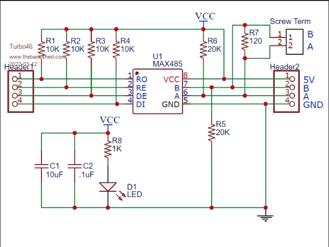

Posted: 10:51pm 11 Mar 2022
For what it's worth, I believe this is the circuit diagram of that RS485 module. The four pins on the outside of the A and B screw terminals are the 5v, B, A and GND pins.
I have used the MAX485 at 3.3v so that should be OK for short distances at least.

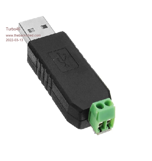

You may find one of these USB to RS485 converters useful if you are doing any development on a PC.
Automatic flow control, no ground connection but works well with an un-grounded device. Available at various places, there are other types with GND connection and more too.

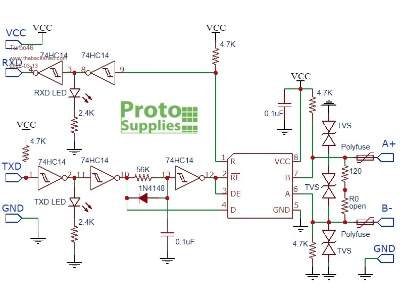

Strictly half duplex Master and Slave communicate over the one pair of wires. The slave does not initiate communication - only the master the slave only answers when spoken to (like a good child - yeah right).
The auto direction control in those devices is normally controlled by an RC network on the Tx line switching a Schmitt trigger. There is some delay in switching the direction at the start of the signal (message) and even more delay switching it off. So it is not really suitable for high speed communications and rapid responses.
I have not done the maths but I would expect that 30 devices on one line would be a few too many. You could use several of the modules in parallel and split your slaves into several separate groups though.
I can't find the circuit right now but if you want it I'll try later. I have a feeling that Mick (Mixtel90) may have had the circuit incorporated on one of his early boards.
Edit: Here 'tis

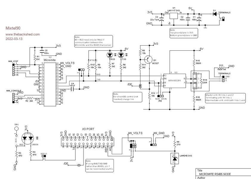

This is what I came up with eventually:
It looks intimidating, but I included inverted and non-inverting options for /EN and most possibilities of termination. :)
