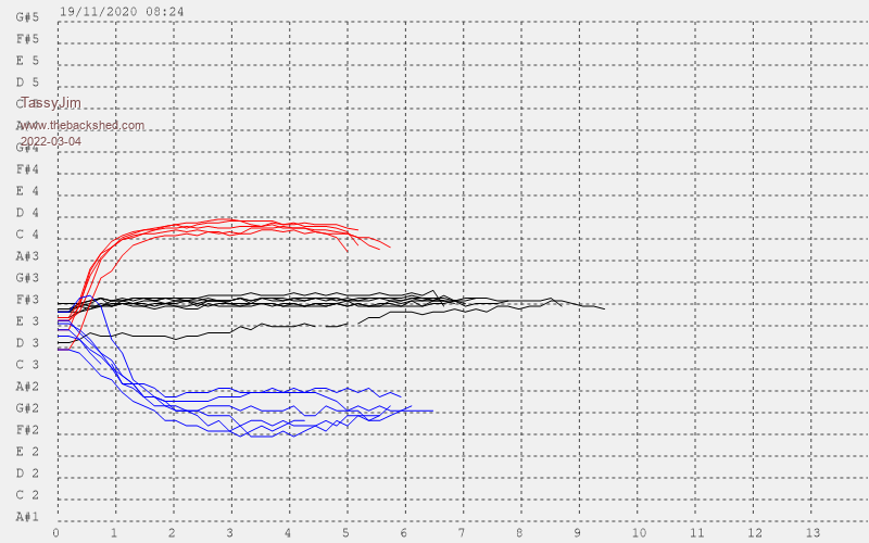

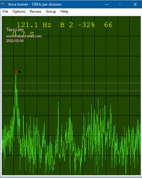

A few years ago I had need for a tool to help with voice exercises.
I couldn't find anything that was exactly what I wanted so I programmed my own "voice Trainer"
And the output:
My speech pathologist was impressed.
I still use most days.
I haven't tried to convert it to the CMM2 and probably never will.
